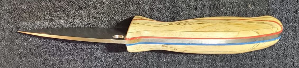

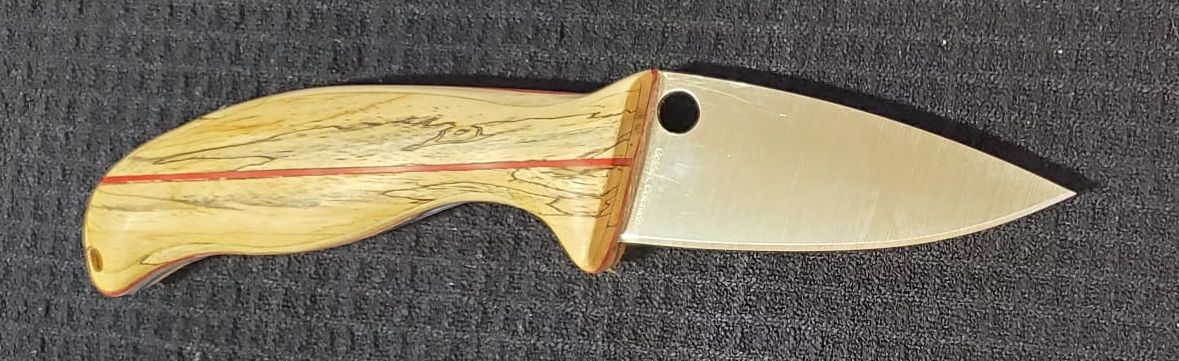

Scales made with my ideal ramp, gap filled with sanding dust/epoxy mix. If you look closely at the top view you can see the filler. I make all my mules with that handle shape as I intend to do some serious stabbing and I do not want my hand to move forward. I use a $14 Ottoza sheath from Amazon
Clever, and looks maximum comfortable.

TTFulltimer wrote:
Tue Apr 04, 2023 11:32 am
Very nice work! I don't have much space or gear but I'd definitely like to make a decent handle soon.

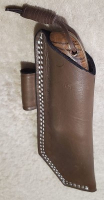

Thanks to TTfultimer for the tip on the $14 sheath, I tracked down what looks like the item in question and will give it a try.

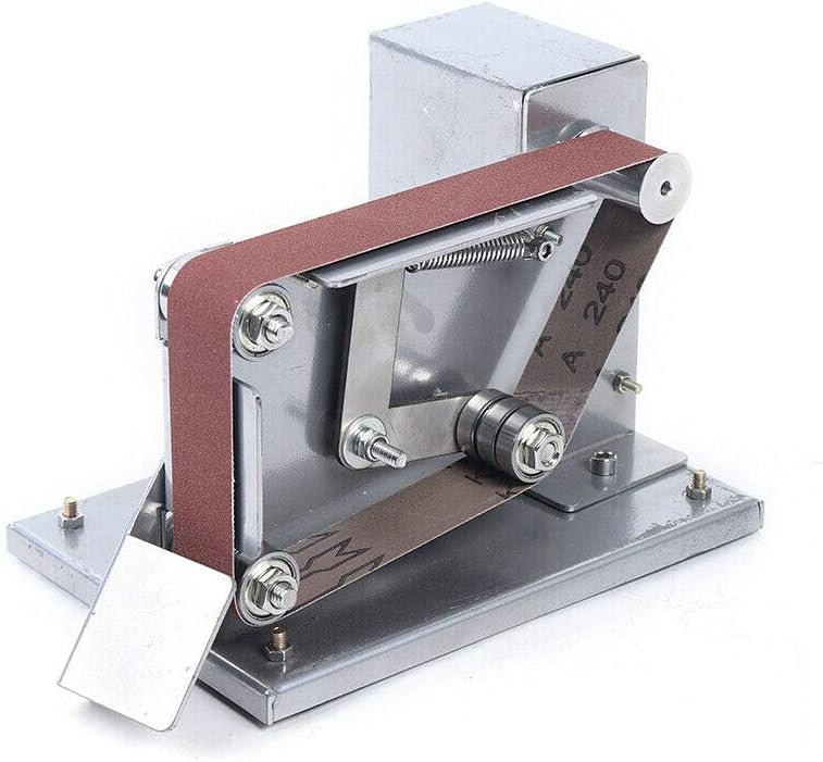

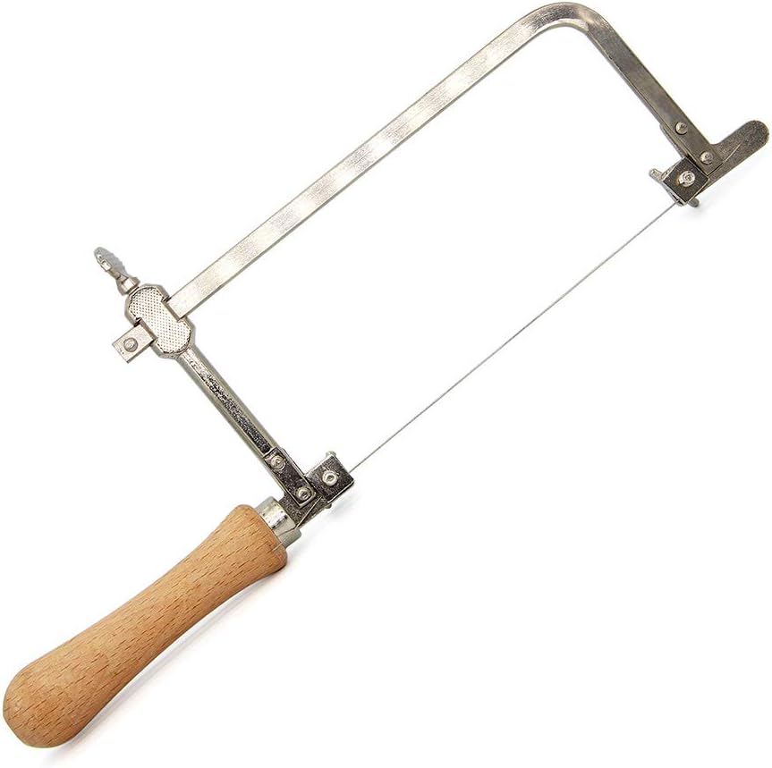

defenestrate wrote:
Thu Apr 06, 2023 4:20 pm
I travel full time so have limited space and weight carrying capability. What I found to use for these smaller wood projects.
Japanese pull saws, adjustable frame coping saw, small drill press, small table saw, small belt sander, and small oscilating spindle sander.

Tucson Tom wrote:
Fri Apr 07, 2023 8:48 am
I trimmed the sheath just a bit, and use a lanyard on the knife.
