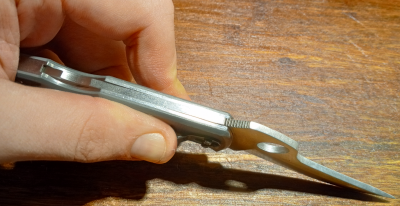

My Ayoob does the lock rock when I cut through cardboard while pinching the scales (rather than thumb against the ramp). It doesn't happen when force is being directed into the thumb ramp. I also noticed some slight lock rock on a ladybug that occurs even on a light cut.
I can live with it but it is pretty annoying to have the blade suddenly pop during a cut.
I took this picture a while ago of how far the lock bar on the ayoob would go if I did a hard cut.
