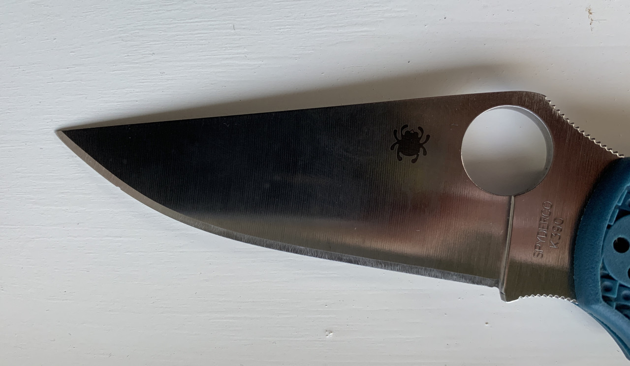

I can confirm. I got a small chip rather than a roll in K390 when I hit a staple in cardboard (13 dps + 15 dps micro bevel). It sharpened out easily.
Looking forward to compare 15V with K390 and Maxamet, when a Manix arrives soon.
