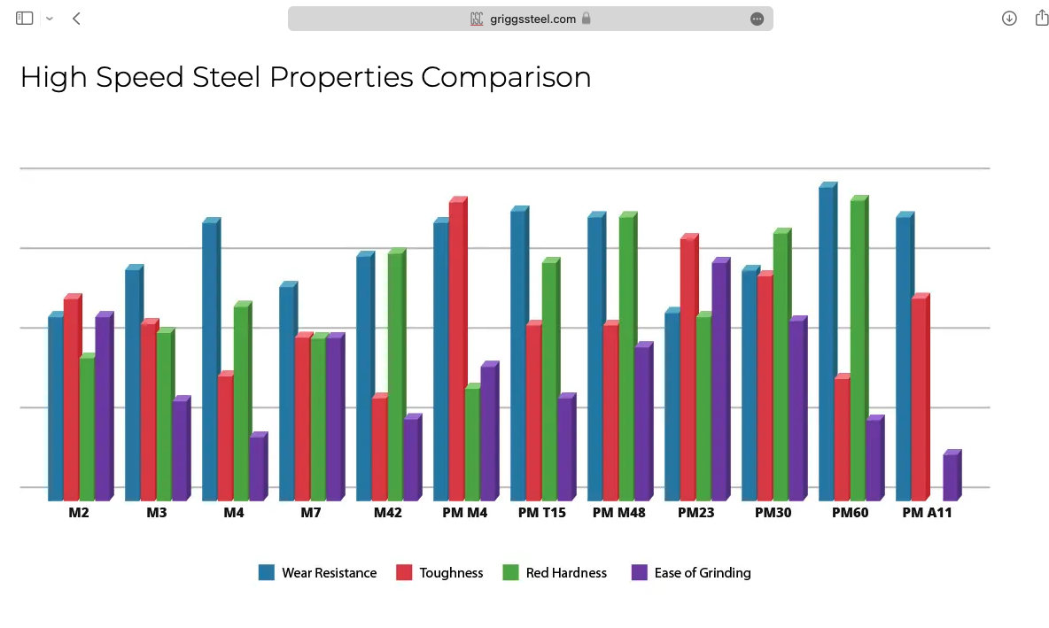

A fun graphic with PM T15 making an appearance (which also shows why PM M4 is such a good knife steel):

Bolster wrote:
Sat Mar 04, 2023 11:28 am
do you know what "red hardness" represents on that graph? idk the term, but these are interesting data

bleasure wrote:
Sat Mar 04, 2023 7:39 pm
I think it means hardness at high temperature, as for a metal cutting bit. Of no interest for a pocket knife blade, unless you are in ****.

Bolster wrote:
Sat Mar 04, 2023 11:14 pm
I wonder if it will enable it to be sharpened by belt grinder with less threat of overheating....
