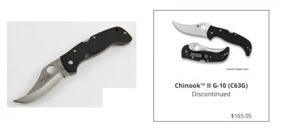

I’m confused by the Chinook line, have several questions. If you can answer any, grateful am I.
1) Why did this model have so many iterations - what was being changed or improved over time?
2) C1 seems to be sought after. Just rareity, or steel, or more favored design/blade shape?
3) Why did C2-4 move away from the original blade shape?
4) What was the difference between C2 and C3?
5) Did the PowerLock of the C4 get used elsewhere?
6) Wasn’t the Chinook’s lock already extremely stout—why did C4 need the PowerLock, was the lock in the C1-3 insufficient for some purpose?
7) After so much development, why did the Chinook disappear from the lineup?
8) How to square this circle: That two of Spyderco’s most SD-focused blades (Chinook & Yojimbo) are in some ways opposites of each other?
9) Would anyone other than me be interested in an updated remix on the original Chinook 1?

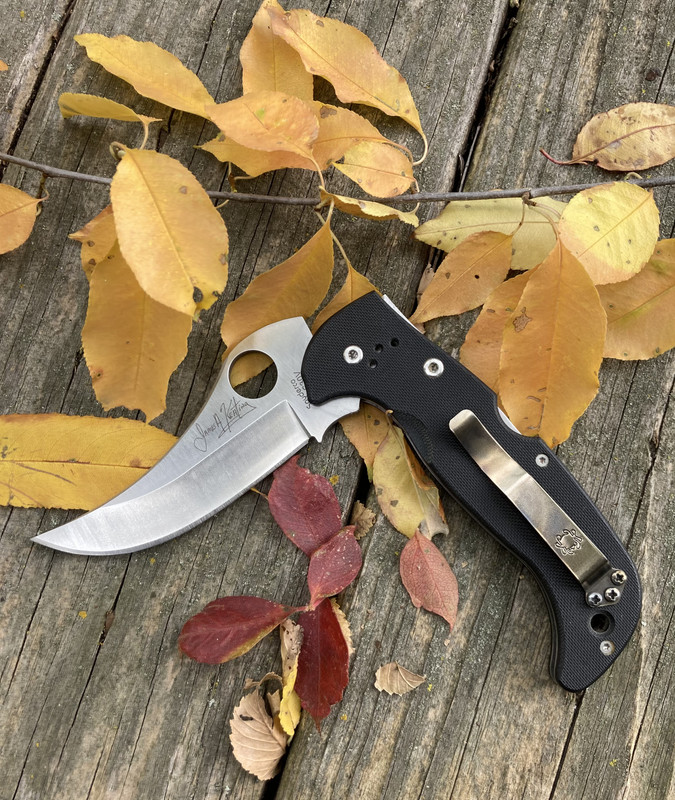

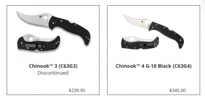

Hey, All:
I've known James Keating since 1994 and respect him as an incredibly insightful and talented martial artist and a true gentleman. When I discussed the Chinook design with him many years ago, he summarized it as "I designed a Ferrari, and what we got was a really great Ford F150." His original design for it, which was expressed in a custom knife made by Ken Onion, was very sleek. Because he wanted to incorporate at least the ripping tactic of Bowie-style back cuts, lock strength was always an issue. Spyderco's expressions of the Chinook always emphasized that quality.
I write all the Product Information Guides (PIGs) that accompany most Spyderco models. Here is an excerpt from the Chinook 4 PIG that recounts its evolution:
The original Chinook was a truly unique folding knife designed by acclaimed personal-defense expert Master at Arms James A. Keating. One of the foremost authorities on the martial use of the Bowie Knife, Keating wanted to distill the quintessential qualities of the classic American Bowie into an all-purpose cutting tool suitable for everyday carry. Released in 2000, the first-generation model of the Chinook featured a thick, hollow-ground blade, an extremely stout back lock mechanism, and a single-position pocket clip configured for right-side tip-down carry. Early production of this distinctive design had blades crafted from CPM® 440V stainless steel, while later knives featured CPM S30V® blades.
The Chinook attracted a devoted following among martial artists, self-defense practitioners, and other knife users who valued extreme strength in their cutting tools. Although impressively strong, the first-generation design was also rather heavy, so in 2003 Spyderco refined it to yield the Chinook II. Its hollow-ground blade had a long, concave clip point and was paired with a longer, narrower handle that accommodated a four-position pocket clip.
In 2006, the Chinook was once again redesigned to yield the Chinook 3. The primary difference between it and the second-generation Chinook was its blade, which had a full-flat grind and a distal taper, reducing its weight and enhancing its deft balance.
Keating designed the Chinook to support the “back cuts”—inverted, clawing cuts with the tip of the blade—he used in his Bowie Knife system. To withstand the rigors of these tactics, the knife needed an exceedingly strong lock. While the stout back lock used in the original versions definitely met this challenge, it also required the knife to be rather heavy. When Spyderco introduced the Power Lock™ in 2014 in the impressive Tatanka™ model, its extreme strength immediately inspired thoughts of other models—including the venerable Chinook. Ultimately, the Power Lock proved to be the key to realizing Keating’s original visions for the Chinook design and inspired the Chinook 4.
For the record, the Tatanka was, to date, the only other Spyderco knife to feature the Power Lock.
I hope this helps.
