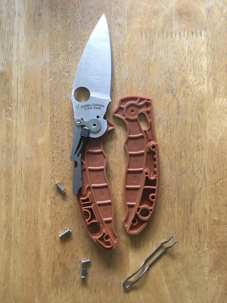

Converted my Rex 45 LW to screwed-together construction:
https://www.bladeforums.com/threads/man ... t-20547888

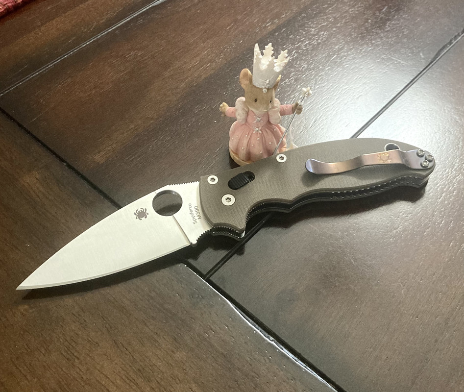

this is my first g10 manix. it's an m390 exclusive that i purchased used from a good friend here on the forum. i replaced the cage with a ti cage from flytanium, the ss ball bearing with a ceramic bearing, and the scales with textured micarta.
ti cage:
while the plastic cage is 100% good to go, i personally don't care for the look and feel of it against the g10 or any other materials. it's fine for the frcp lw manix, but i don't really like it in any other context. the ti cage has a very solid feel and the texture on it is reminiscent of spyderco's jimping. i find that it's noticeably easier to operate because of the extra purchase. i will say that i've noticed it's harder to operate with one finger though. i'm guessing the shaft that rides inside the spring is binding more than the plastic would because trying to operate the lock with finger gives me more resistance than the plastic cage does on my m2lw. it's not a real downside, but it's a data point for consideration in case anyone else here ever disengages the lock with one finger rather than a pinch grip.
ceramic bearing:
the manix is already smooth on the stainless ball bearing, so this "upgrade" is even less necessary than the cage upgrade. i found no real benefit to switching it out, other than just the cool factor of knowing it's upgraded. i feel no discernable difference in action, but the action is great nonetheless.
micarta scales:
this upgrade really changed the feel of the knife. at first, i wasn't sure i liked it. overall, it feels more narrow in my hand and i almost feel the jimping even more than i did before. that doesn't really bother me, but i know it would for others. also, the lanyard hole fit isn't super tight, so i can pry the end of the knife apart if i want to. after using it in this configuration though, i really like it a lot. the texture of the grip is nice and i prefer the overall feel to my rec manix, which i've left stock. the lanyard tube fit isn't a problem in use or in pocket, so it's a non-issue for me. i would definitely recommend these scales if anyone is looking for an upgrade and doesn't hate the jimping on the manix handle.
overall:
the manix is a great knife the way it comes from the factory. none of these customizations were necessary to make it a better knife. however, i really enjoy this knife more now knowing that i've made it mine, and i actually like the upgrades. if you're thinking about customizing a knife that you really like, go for it. if you're thinking about any of these upgrades, i hope this information was helpful.

LB, that is interesting about the cage riding a little tighter. Something I will consider. Not sure I would like it any stiffer and for the cost, that may be enough for me to avoid that upgrade.
Would you say the cage sticks out any further? Maybe giving the feel of a little more purchase area when gripping the cage?

if you use a pinch grip to disengage the lock, you shouldn't notice a difference. it really only binds when i try using only one finger, which then puts the shaft at an angle and can cause a little bit of extra friction. i wouldn't say it's actually any stiffer to operate.JSumm wrote: ↑Thu Dec 29, 2022 9:14 amLB, that is interesting about the cage riding a little tighter. Something I will consider. Not sure I would like it any stiffer and for the cost, that may be enough for me to avoid that upgrade.
i wanted to mention the width of the cage as well, but i'm not 100% sure on that, so i left it out of my write-up. i think it does stick out a little bit more on each side than the stock plastic cage, making it easier to grab, but since my scales are not the same thickness as stock scales, it's hard to say for sure.

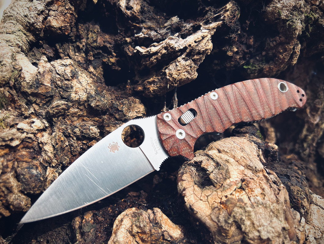

I might have the most heavily modded Manix 2? Custom skeletonized liners, blade swap, regrind, handle reshape.
viewtopic.php?t=70091
This is the current state.
