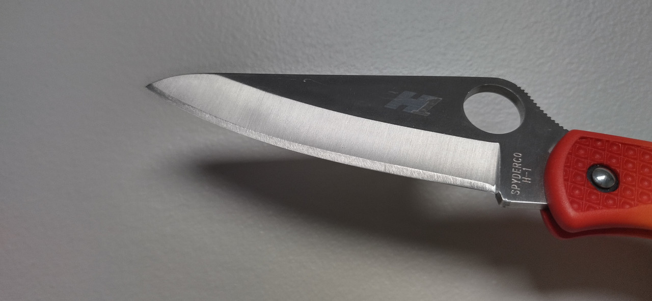

Senfkarte wrote:
Wed Nov 09, 2022 1:36 pm
This was kind of overdue, my first time sharpening a SE blade. Since I own this knife, it was in my pocket approximately 80% of the time.
This was before
Every tooth was bend. Some more than the others. Does not look too bad in the pictures but one could feel it without a doubt. The PE part of the blade has been sharpened before.
This is after
The teeth are still a bit pointier and I needed more time to remove the burr, than I have expected. But now it is shaving sharp and ready to be back in my pocket.
You seem to have done a nice job ! I have to admit that removing the burr on a SE knife still takes me more time than on a PE knife, because I often have on small spot or two where the burr remains and the rest of the edge is ok.
I acquired a dragonfly SE in H1 and I really do not like how it cuts, I guess I have to soften the peaks but it is an operation I have yet to try on a SE knife. I might just let it live its life until we get there.
Thanks. And yes, I had the same thing with the burr. For me, that halves of the arcs, that are more near to the tip, were hard to deburr. I think the angle between the blade and the stone was not perfect and as a result I made it harder to get rid of the burr.

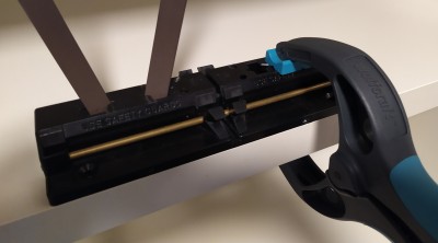

dullmaker wrote:
Sun Nov 20, 2022 11:16 pm
I just started using the gauntlet and It worked much better for me than the Sharpmaker-much more contact with the stone.
Sharpened a k390 Endura and was amazed how easily k390 responded to the fine stone on the Gauntlet.
Any ideas how to mount the Gauntlet so I can hold the knife with two hands? Any suggestions are appreciated.
Bruce
I always clamp my sharpmaker down. Maybe something similar is possible with the gauntlet, too? Don't know, how much space there is.
