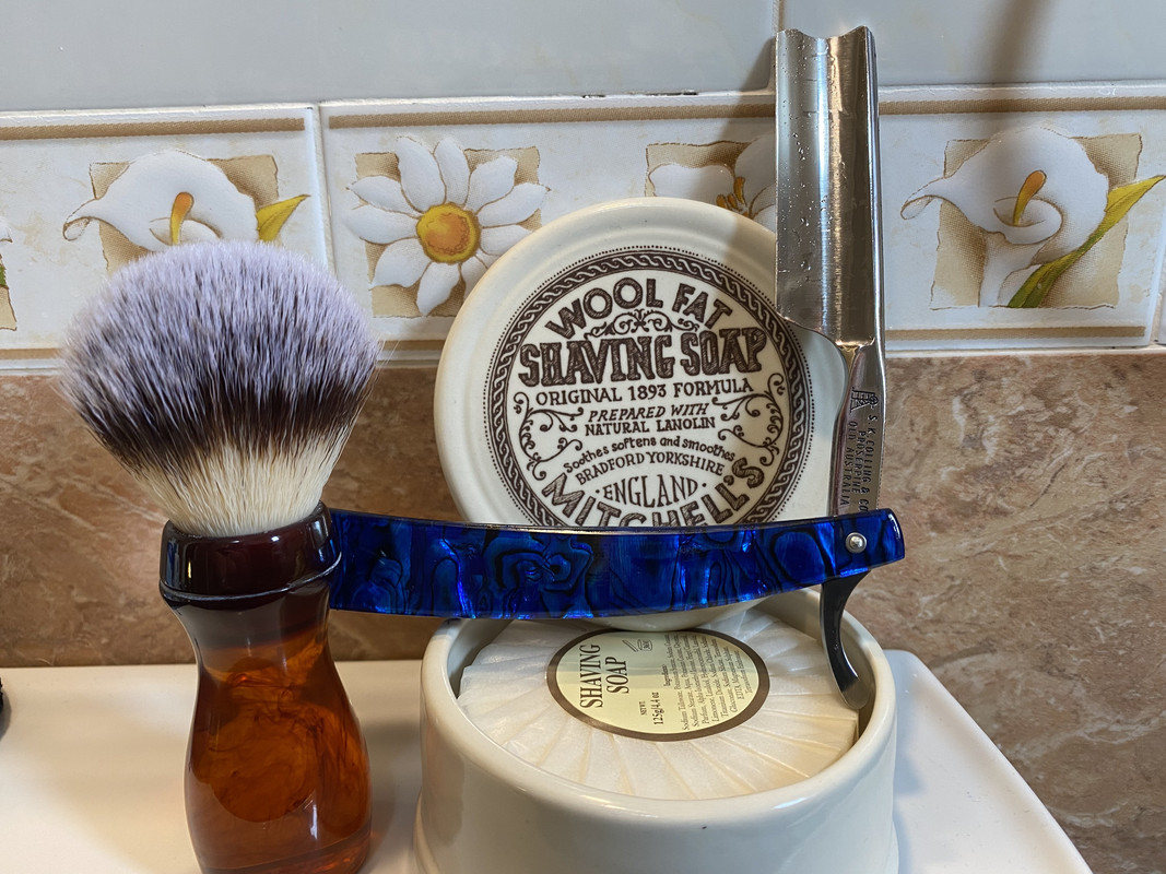

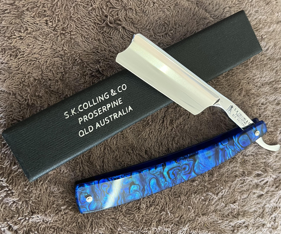

I got my new S.K. Colling straight razor yesterday and shaved with it today. It is beautiful, better than the pictures could ever show. It is well balanced and a joy to use, inspiring confidence.
Steven was easy to work with and very responsive to my emails. We discussed what I wanted and agreed on the price. Simple and uncomplicated. He got right on the project and had my razor ready to ship in a couple of days. I can't recommend him any higher.
S.K. Colling stands for, I assume Steve and Kelly Colling. He is in Prosperine, QLD, Australia and his company is also known as Prosperine Razor Company. https://www.facebook.com/steveandkelcolling

Had my second shave with the new Colling. Superb. This razor is extremely well balanced and confidence inspiring.
I'm still hoping and waiting on Spyderco to come out with such a razor. I'd suggest working with a company like S.K. Colling or others that have the experience to turn out good razors.
