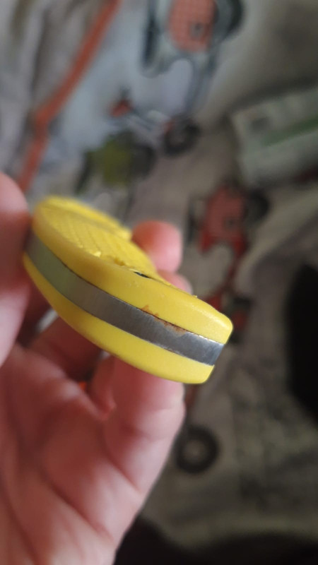

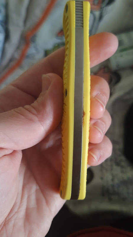

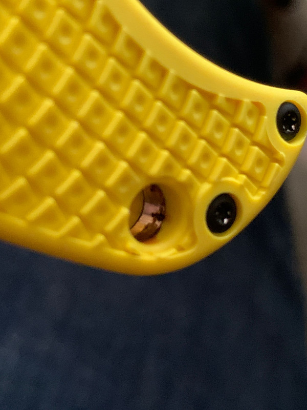

Hello Sal and team :) I recently gave an enuff2 h1 to my partner since he has become a scuba diver and wanted him to carry a good knife! This seemed perfect to me because of the size, shape, steel and spyderedge!
It fits perfectly in your hand, the frn gives a great grip and the yellow color gives peace of mind in case it slips out of the case. In this way she could see the quality of the products she bought, 90% of my knives are from spydreco and thus be able to justify this hobby a little.
After 1 hour under the water and its subsequent rinsing with fresh water, when checking it we saw that it was sweating rust under the scales. We cleaned what we could but on the next dive, coming out of the water it had rust again and it seems that under the brake it has a considerable amount of rust.
I am surprised as it has not happened to me in any of my other Salt knives, the others are folding knives, pacific salt2 h1 SE and salt2 PE and SE in LC200N. The salt2h1 has seen more than 2 years of salt water practically every day and has not a trace of rust! Any suggestion?
Thanks in advance!

First guess would be a surface contaminant between the tang and scales -- possibly from a grinding belt. My general understanding is that rust begets rust. Not sure if H1 is immune to this. Have you tried removing the scales? I'd use flitz polish to polish away an potential contaminant from the tang and screws, clean the scales, and then see if that stops the rust. If the rust persists, spyderco may request you mail the piece to Golden, CO. Good luck
Re: Corrosion Reports
If I remove the scales, does it affect the warranty?dlum1 wrote: ↑Tue Oct 18, 2022 11:43 amFirst guess would be a surface contaminant between the tang and scales -- possibly from a grinding belt. My general understanding is that rust begets rust. Not sure if H1 is immune to this. Have you tried removing the scales? I'd use flitz polish to polish away an potential contaminant from the tang and screws, clean the scales, and then see if that stops the rust. If the rust persists, spyderco may request you mail the piece to Golden, CO. Good luck
Thanks for the idea!
That's a good question; I'll have to let someone else chime in here. I doubt it, but spyderco may have a black and white warranty policy about hardware removal. I'm glad you asked before proceeding, because I clearly would have jumped in head first.

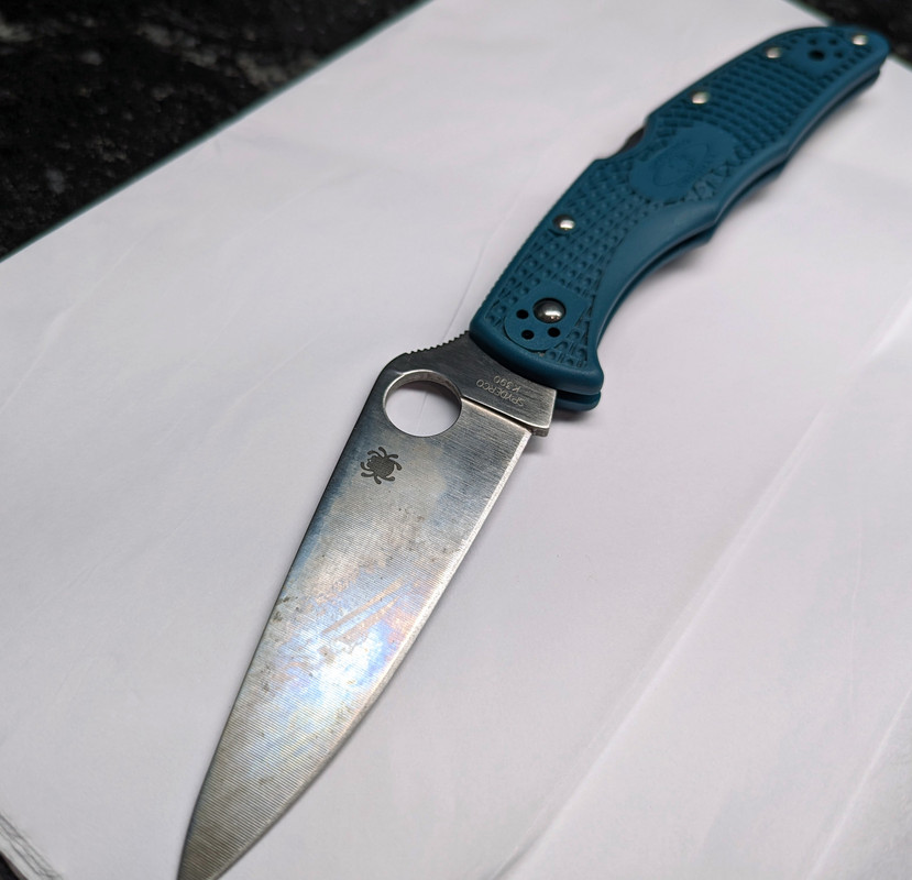

Ok folks, I'm in need of some advice.
I carried my K390 PM2 for about two years before developing any kind of corrosion. I think I "put it away wet" one day, likely covered in tape residue/adhesive, and came back to it about a month later. When I cleaned the residue off, I found this dark spotting on the blade.
I've tried rubbing the blade down with Flitz + a rag, to no avail. I supposed the next step might be fine steel wool, but I worry about ruining the finish on the blade.
Can I get some advice about what my next steps should be to stem the tide? Ideally, I get rid of the spots entirely, but if I can't reasonably do that I'd just like to make sure that I'm not going to lose one of my favorite knives here.
I say let her ride.
I think K390 builds a beautiful patina.

I'm not 100% opposed to this. I guess my question is: will this turn into destructive corrosion, or is it just that - patina?
Looks like just a patina. Most likely safe if it is not red or orange. I have found K390 to patina quickly, but not develop rust easily. On the flip side, I have seen orange spotting on ZDP-189, but no patina.kennethsime wrote: ↑Sat Dec 03, 2022 11:43 amI'm not 100% opposed to this. I guess my question is: will this turn into destructive corrosion, or is it just that - patina?
