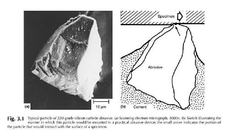

First I would like to quote words from this article (I recommend reading it all)
https://scienceofsharp.com/2016/12/21/a ... t-vs-grit/
In the study and literature on the topic of grinding and wear (tribology) the terms “sliding, ploughing and cutting” are commonly used. There is a critical pressure required for an abrasive to cut into the workpiece, otherwise it will simply slide without removing metal. Efficient grinding occurs when the particles are cutting. If the exposed abrasive becomes worn, the contact area increases and the effective pressure decreases (for a given applied force) and we will move from cutting to sliding.

In your example, you missed that the ball is not fixed motionless. Your example would work if the ball had a comfortable handle to hold, so that you could create a pressure on the ball, to move along the sheet.
The grain of abrasive in the stone is not fixed motionless, it is kept due to "glue". Glue can be strong(norton india) and weak(king stone). There will be some kind of pressure on the abrasive when the abrasive will break out of the stone. The more round abrasive (dumb), the more it must be pressed on the stone, so that he again begins to cut the metal. This pressure can be so large that the whole stone will destroy, or it will not work to do anything.

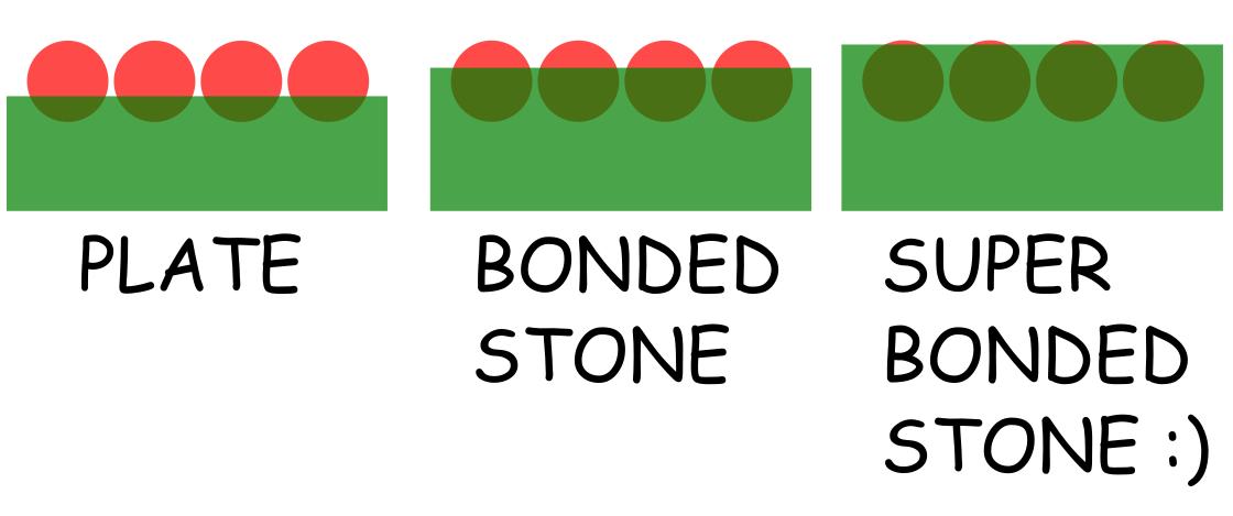

Ramonade wrote: Resin bonded diamond stones and electroplated stones do not only differ in lifespan. As Shawn said, since the diamond are IN the bonding medium, they are not showing all the way. The grit stays the same, they cut as efficiently as electroplated stones for the same grit.
However, there's a difference in how deep the electroplated diamonds go in the steel, and this is the case for every grit. When your using 220 grit it's not that important, but at very high grits and given the choice, you'd prefer a resin bonded diamond stone for a cleaner edge (= sharper)
This is a very very controversial statement.
I drew a small picture, this is a type of abrasive stone, depending on the depth of immersion of an abrasive into the matrix.
For comparison, I suggested that the density on the surface of the abrasive is the same in all stones
I do not know what you mean by the word - effectiveness. But the following logic (The grit stays the same, cut as efficiently same, difference in how deep), the best stone will be the one whose abrasive will be deepened to maximum depth (Perhaps even the one from which the abrasive will not stick out? :thinking ). Since the effectiveness does not depend on the depth of the adjustment. And the scratches from abrasive will be less, the more abrasive is immersed in the matrix.
Do not you think that what is wrong here?
If I misunderstood you, please draw you as you imagine these two cases.

Nice explanation.
