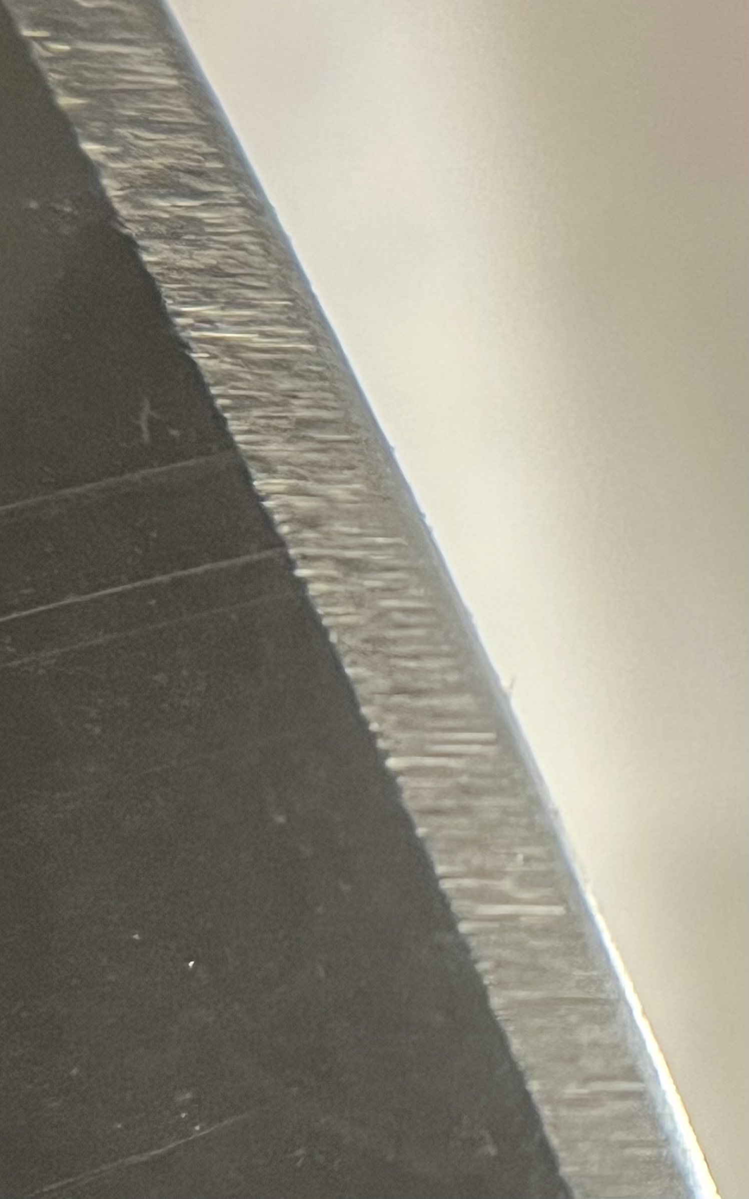

What edge (dps) would you recommend putting on this steel? I know many go for a 15dps here on the forum, that is how I will sharpen my Cruwear, but I would think with a knife like this, lower on toughness, a 17dps grind to thin the edge out with a 20dps micro bevel to help with chipping. At least that is were I would start.

Great information as always and it makes a ton of sense. Right now I free hand with a Worksharp system and touch up the edge on Sharpmaker. I was thinking of getting a guided system but since I generally prefer a slightly tougher edge maybe I should stick to free hand even though I tend to round out the tip accidently. I included a picture of my last sharpen, S30V at 17dbs by hand stopping at course with a 20dbs micro bevel on the Sharpmaker.
For anyone wondering it was taking with a iPhone and a small loop, works pretty well.
Ah, using magnification. That's always a good idea I remember I used to be more resistant to using magnification to look at my edges because I like the idea of being able to feel them without needing to look at them which I felt could develop as a crutch but I noticed that Sal would always look at all the edges and he was a very big proponent of that. Well Sal has been sharpening for longer than I've been alive so I figured it was worth looking into more.
I think the best part about it is that we could show pictures of what we were talking about with each other and better understand.

Factory Edge was removed.
This is the CATRA protocol edge using an Edge Pro with a 400 grit Cubic Boron Nitride metallic bonded at 15° per side.
Very crispy, with excellent aggression and bite. It can be difficult to get an edge this sharp with such a low grit, this is where the special heat treatment can help.
We can lower the bess score with higher grit and polishing but we loose the bite and aggression with draw cutting for more keenness and push cutting.
