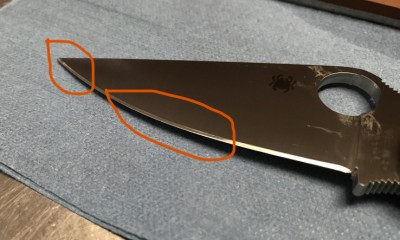

All these observations are just clues. Even if you have a lot of clues, you still need to interpret them. The picture you posted contains clues, too. Admittedly, it's hard to take pictures if knives because there are often strange reflections, lighting problems, etc. So you'll have to look at the knife to be sure of what I think I see.
The EdgePro gives you a flat bevel. If you have a teeny tiny straight edge, you should be able to lay it across that bevel and it should look flat. Take a look at the picture below. The parts that I encircled show dark shadows and light reflections. That seems to indicate multiple angles. Maybe it's just the lighting, or maybe it's a real problem at the edge. You'll have to look closer to know for sure. At least it's a clue.

I took another stab at it after a break to clear my head. Started with 120 and worked it until I had a burr on one side, than I tried to remove the burr on the other side, using a piece of paper as a sharpness guide. After it was sharp I moved on up the grits. Edge is a lot better and more consistent now. It's fairly sharp now, and much better than it was. Using patience and trying to go through each step with precision helps a lot. When my loupe comes in I will work on another knife to practice and actually see what is going on with the edge as I sharpen. Thanks again for all the excellent advice from you fine folks!RustyIron wrote: ↑Mon Sep 19, 2022 3:39 pmAll these observations are just clues. Even if you have a lot of clues, you still need to interpret them. The picture you posted contains clues, too. Admittedly, it's hard to take pictures if knives because there are often strange reflections, lighting problems, etc. So you'll have to look at the knife to be sure of what I think I see.
