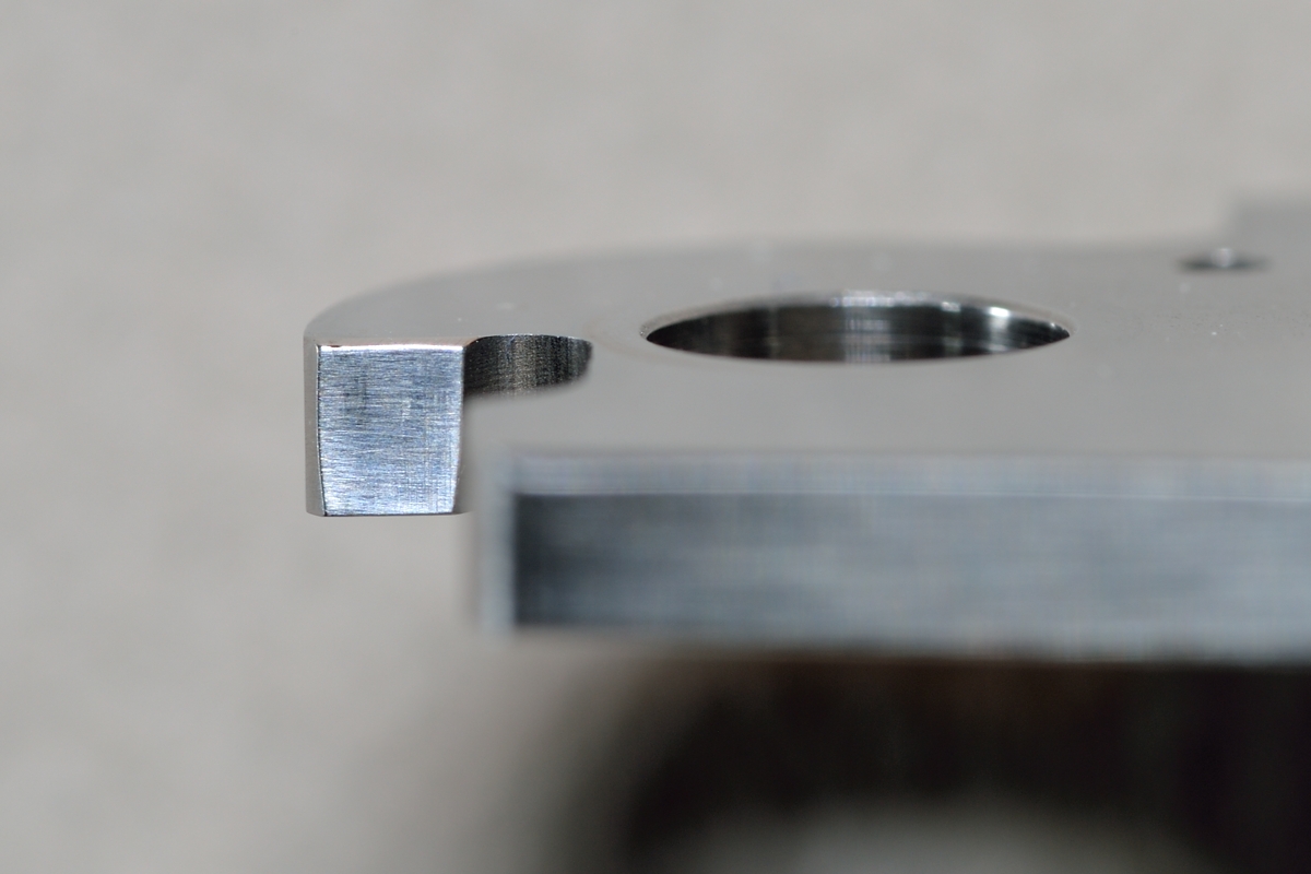

I'm posting these photos to show the near-fatal damage I did to the lock bar and tang locking faces in trying to solve the lock stick problem (before realizing that it's locking depth that's the determining factor).
As I've already said, smoothing off and polishing the locking faces had NO beneficial effect in eradicating lock stick from this knife.
If anyone else is minded to remove metal from these parts, compare your unaltered part to these first.
On these, I definitely think I went too far (and for no gain).
Luckily, I just got away with it without writing off the knife, i.e. creating permanent lock rock.
In fact, the knife is running well now. Lock stick can be dialed in or out with the pivot screw alone.
Moral: be very wary about removing metal.
You may end up down a very sad rabbit hole!
