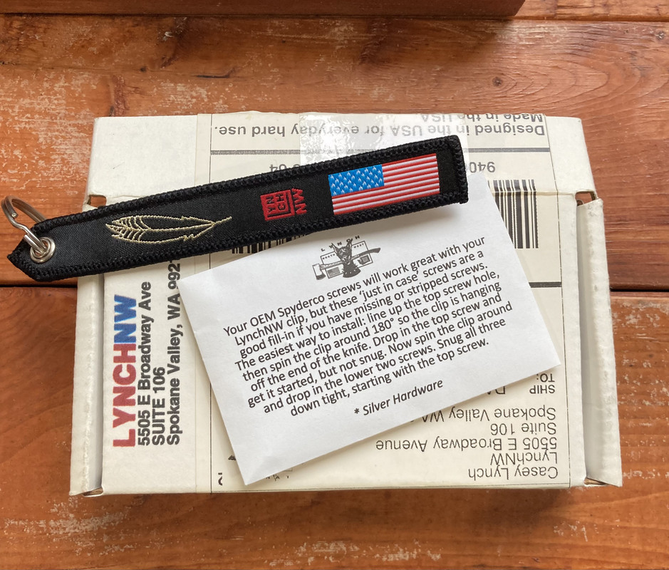

Hi buddy , all my Lynch clips have come with extra screws .JSumm wrote: ↑Mon Aug 01, 2022 7:32 pmexactly what CJK said. That is my experience too. I believe all my MXG clips have come with screws for that exact reason. Usually you can see the difference side-by-side. Lynch I don't remember getting screws, but never had a problem with them fitting with factory screws.

I will dig out my Lynch box of extras . I believe they either come in a ziplock or white envelope. Factory screws for Endura and Pacific are different lengths because of liners holes in clips are a little diameter size off also .JSumm wrote: ↑Tue Aug 02, 2022 2:02 amOh dang. That is weird then. The last one I got for the Polestar did not. Now I wonder if my others did. It has been awhile since I got those. I do know like CJK said, if you put the Lynch & MXG side by side, you can see a thickness difference. I recall Spyderco screws being a little short for some in the past for the MXG.Manixguy@1994 wrote: ↑Mon Aug 01, 2022 8:31 pmHi buddy , all my Lynch clips have come with extra screws .JSumm wrote: ↑Mon Aug 01, 2022 7:32 pmexactly what CJK said. That is my experience too. I believe all my MXG clips have come with screws for that exact reason. Usually you can see the difference side-by-side. Lynch I don't remember getting screws, but never had a problem with them fitting with factory screws.
Dan
Being quite the nerd, I measured all three. The Spyderco hourglass clip and Lynch are about 1mm thick. The MXGs are about 1.3mm thick.
Dan
Re: Noooo! Stripped threads replacing clip on my new sprint run Shaman.
Wow! And a keychain! My last order just had the clip and a nice personalized note.Manixguy@1994 wrote: ↑Tue Aug 02, 2022 5:57 amJSumm wrote: ↑Tue Aug 02, 2022 2:02 amOh dang. That is weird then. The last one I got for the Polestar did not. Now I wonder if my others did. It has been awhile since I got those. I do know like CJK said, if you put the Lynch & MXG side by side, you can see a thickness difference. I recall Spyderco screws being a little short for some in the past for the MXG.Manixguy@1994 wrote: ↑Mon Aug 01, 2022 8:31 pmHi buddy , all my Lynch clips have come with extra screws .JSumm wrote: ↑Mon Aug 01, 2022 7:32 pmexactly what CJK said. That is my experience too. I believe all my MXG clips have come with screws for that exact reason. Usually you can see the difference side-by-side. Lynch I don't remember getting screws, but never had a problem with them fitting with factory screws.
Dan
comes with driver too . Hope this helps

You know what, I was curious so I just checked his website. The standard Spyderco clip mentions it comes with wrench and screws. The one I just recently purchased for the Polestar (Tenacious Clip on the site) does not mention screws or wrench in the description like the Standard Clip does.

I'm curious what kind of screws (thread sizes) LynchNW sends out or if he sends out different ones for Spydercos for different countries.

lol. I actually DID do this AND got my question answered (Friday) but I didn't read the email until today. They just send out 2-56 which do seem to fit the Japanese stuff as well. 2-56 and M2.3 x 0.4 must be "similar enough" to work.Manixguy@1994 wrote: ↑Tue Aug 02, 2022 6:39 amI would reach out to Casey on their site for the correct answer . MG2
