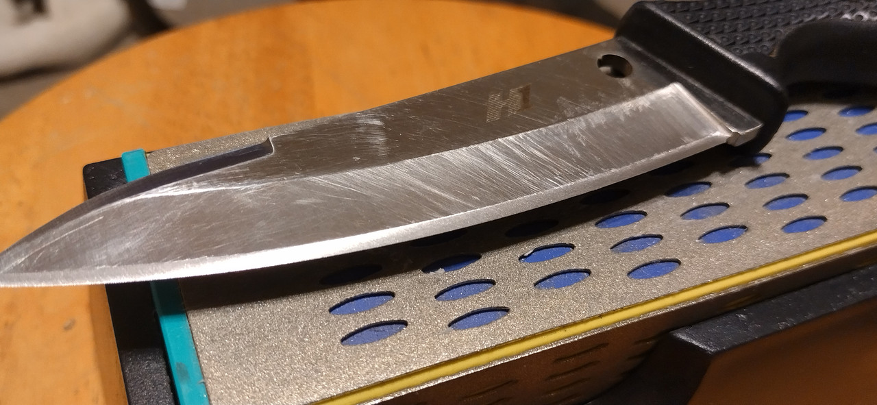

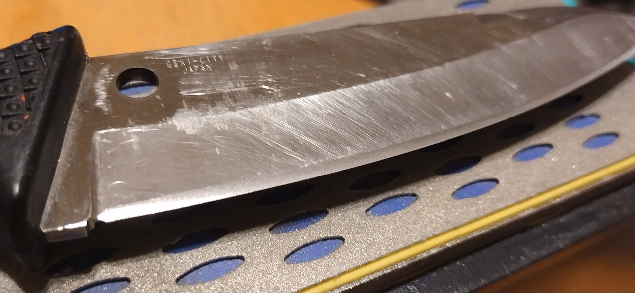

On these 4 sided diamond stones I typically use them as follows:
200 grit side - reprofiling
300 grit - final edge
400 grit - typically not used, been trying it out at work lately
600 grit - never used, not a fan of how polished it is
I've experimented with 200, 300 and 400 grit edges, and I like 200 & 300 the best.
I generally go with 300 grit for the final apex because the 200 grit side gets broken in fast after re-edging a few knives.
I've compared worn versions next to brand new ones. The worn ones give a finer edge comparing the same grit to a fresh one, as you'd expect.
I've got 4 at the moment. Two brand new back-ups, my first one I use at work, and a newer user I keep at home.
I like the more aggressive edges I get from the fresher stones. Which is the main reason I use 300 grit for the final edge.
For a while I kept two of these in use at home and would reprofile with one 200 grit, and use the fresher one for touch-ups and final apexing.
My baseline expectation is "clean scrape shaving" off the 200 grit side fresh out of the package, and hair popping sharpness off the 300 grit side.

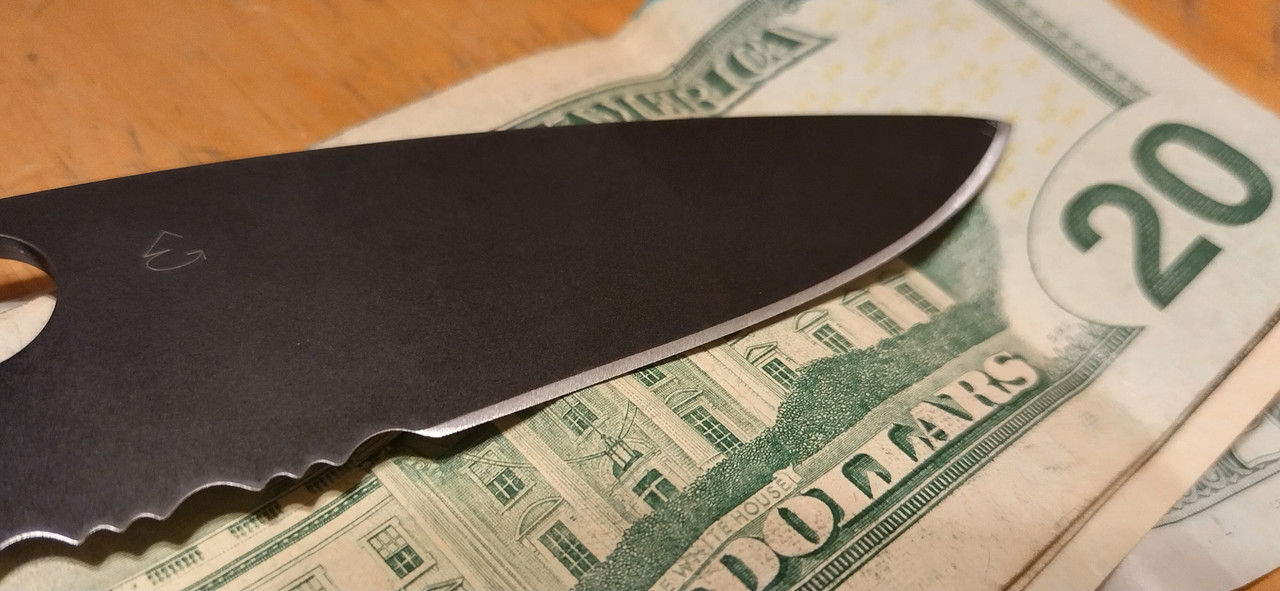

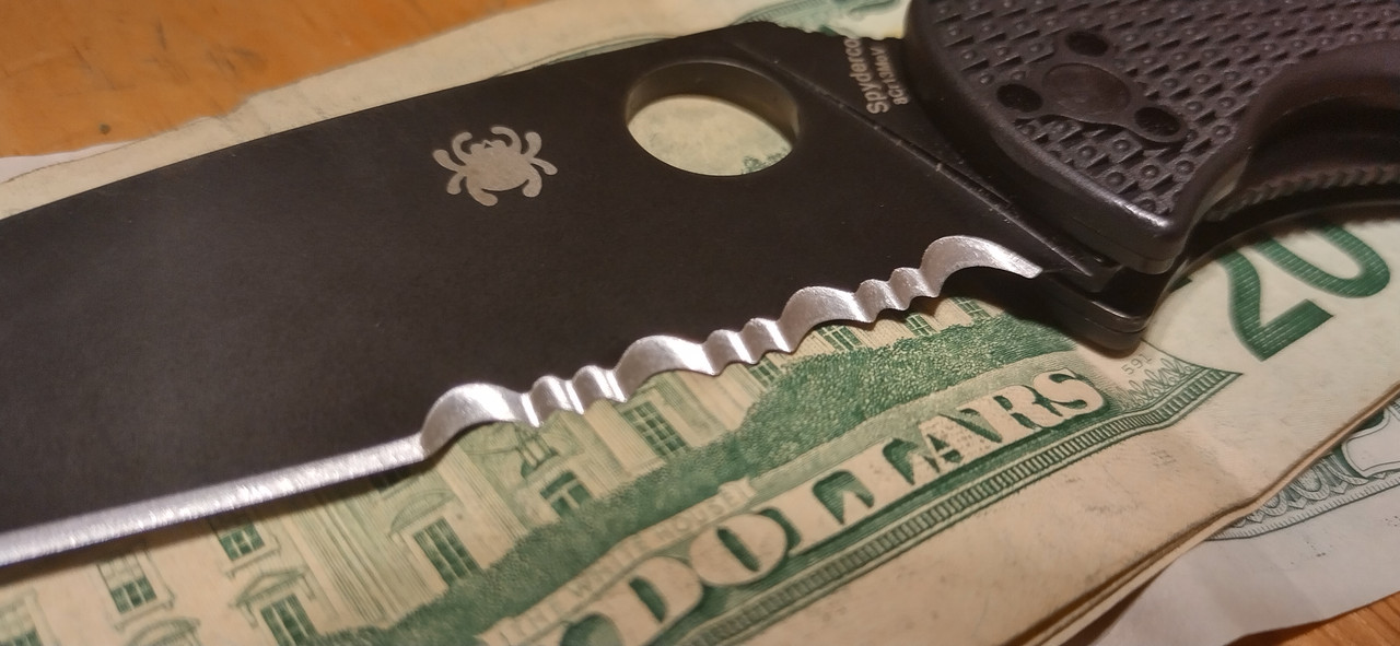

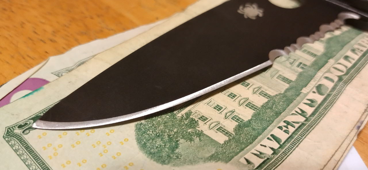

some recent touch-ups:
street beat
street bowie
aqua salt
took the serrated portion of my ce resilience down from ~23 degrees to 20.
still need to go back over it and smooth things out, this was right after I ground off all the sharpie with the diamond rods. Next I'm taking the PE portion a bit thinner and coarser. Once I'm done seeing how long it takes to dull my Pacific, I want to give it some pocket time. Big fan of this knife.
Posts: 15621
Re: Community Sharpening Journal
#1435

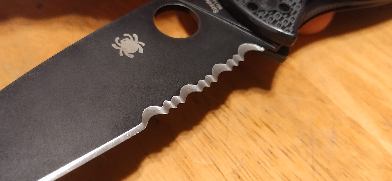

finished the resilience during my break today. went with medium rod finish for the serrations and 300 grit diamond plate for the plain edge. stropped both parts with 1 micron twice per side. either section will catch hairs above the skin.
Excited to use it. Both parts of the edge are a little thinner and sharper than they've ever been.
cabfrank
Posts: 3370
#1436
Post by cabfrank »
It looks so good.
Posts: 13199
#1437
Really does, so coarse yet clean. That's probably best looking combo edge I've seen.
Posts: 15621
#1438
Thanks! Happy with how it turned out. Couldn't resist carrying it today.

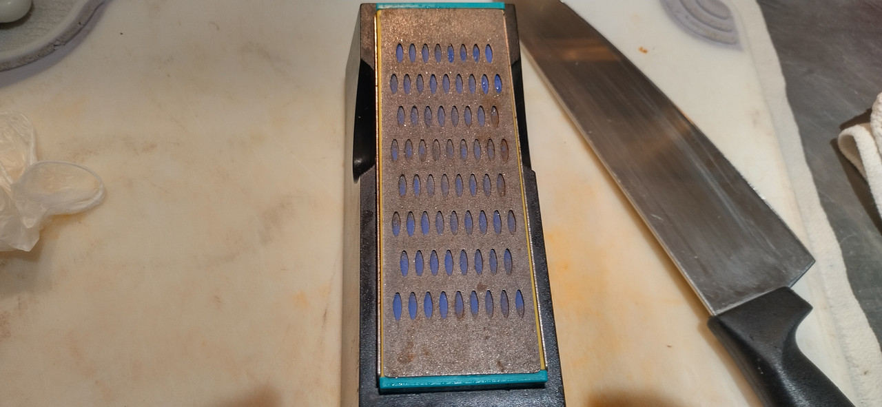

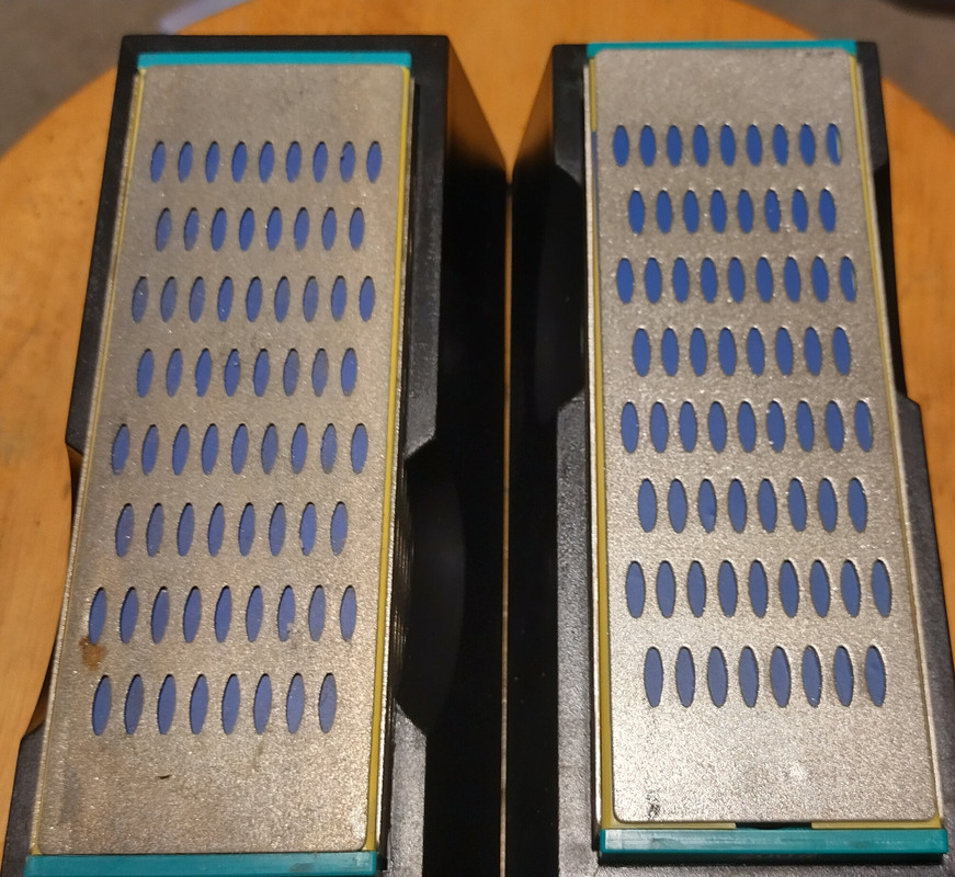

Wed Jul 20, 2022 11:42 pm
I cycle those $12 harbor freight stones. I don't have my most worn one handy as I keep it next to my knife roll at work, but here's the one I use at home VS a brand new one:

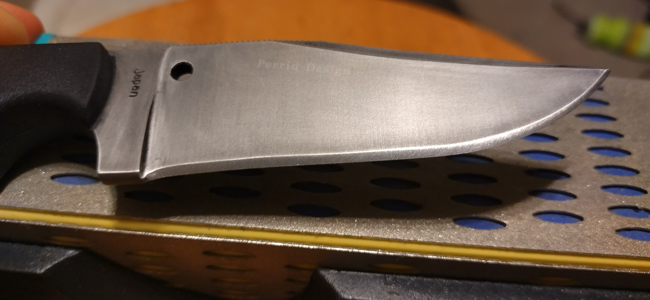

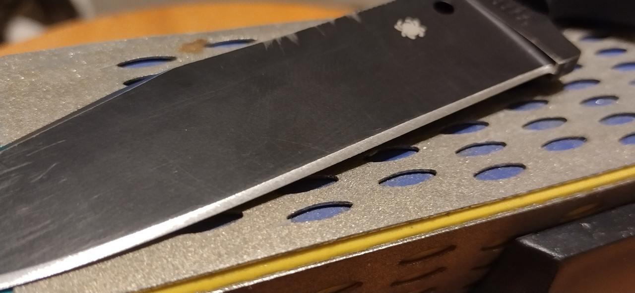

Here's my oldest for comparison:
Used it to touch up my beater chef knife. A $20 portugese knife.
Wandering_About
