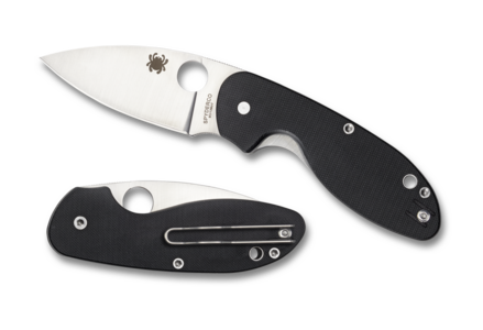

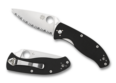

There are also models like the Astute, Tenacious, Persistence, and Efficient in G10 that you can find around $50. Will not break the bank and IMHO have great quality.

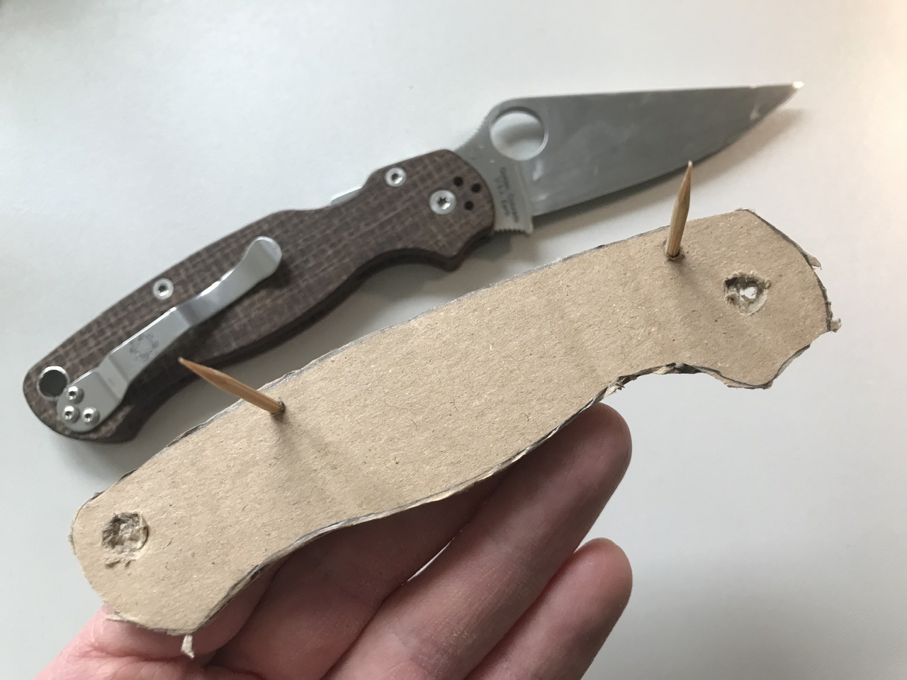

My cheap DIY scales 😁

Also, I love the cardboard and toothpick scales Oloung1! :hand-over-mouth

Whoops, I meant Matus's scales.
