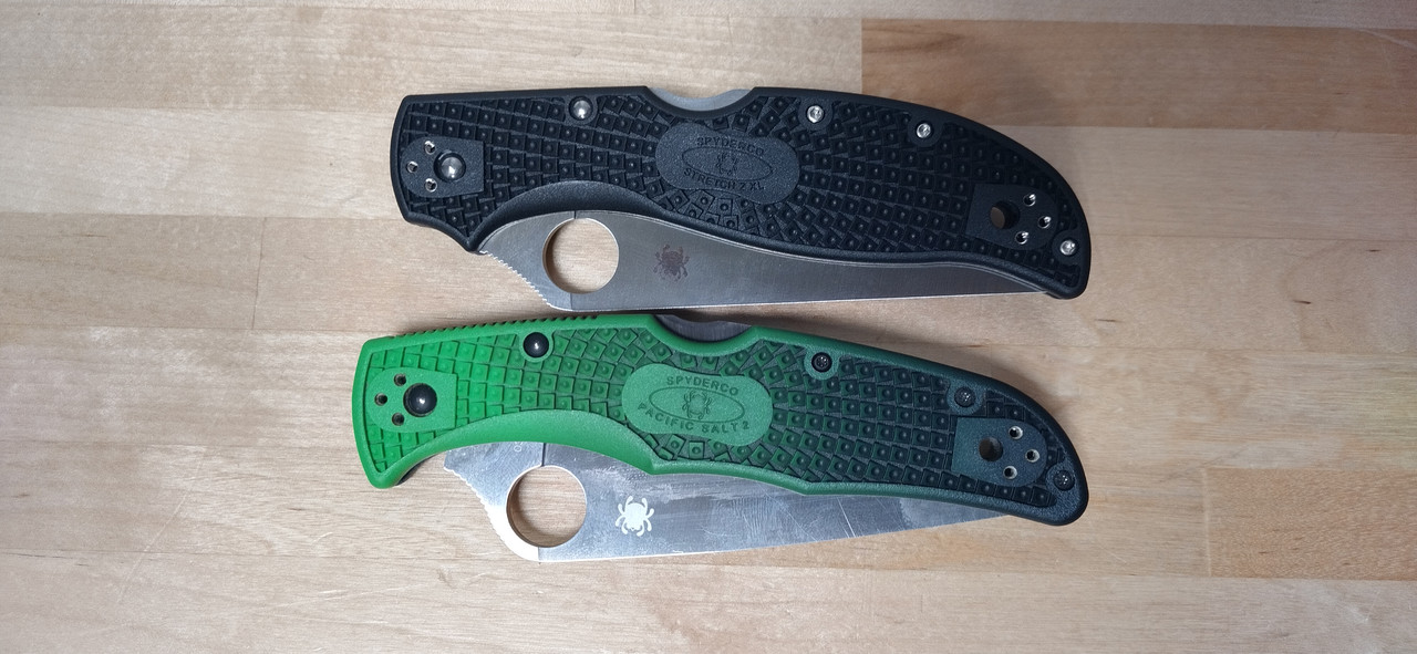

Here's the only one of mine that's faded.
freshly dyed
recent pics.
pretty subtle change really.
freshly dyed
recent pics.
I actually like the way that fade looks.

I think the wear actually looks pretty cool on some models. Other companies charge you for the apocalypse worn out patina look but you can just dye a yellow handles whatever color you want and let wear take it's course.
