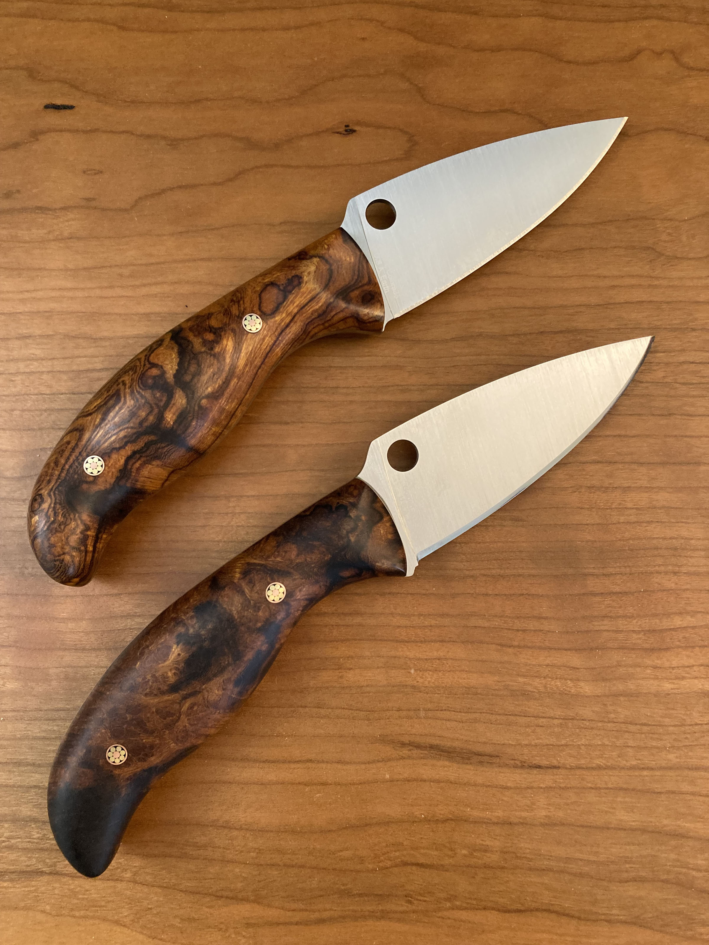

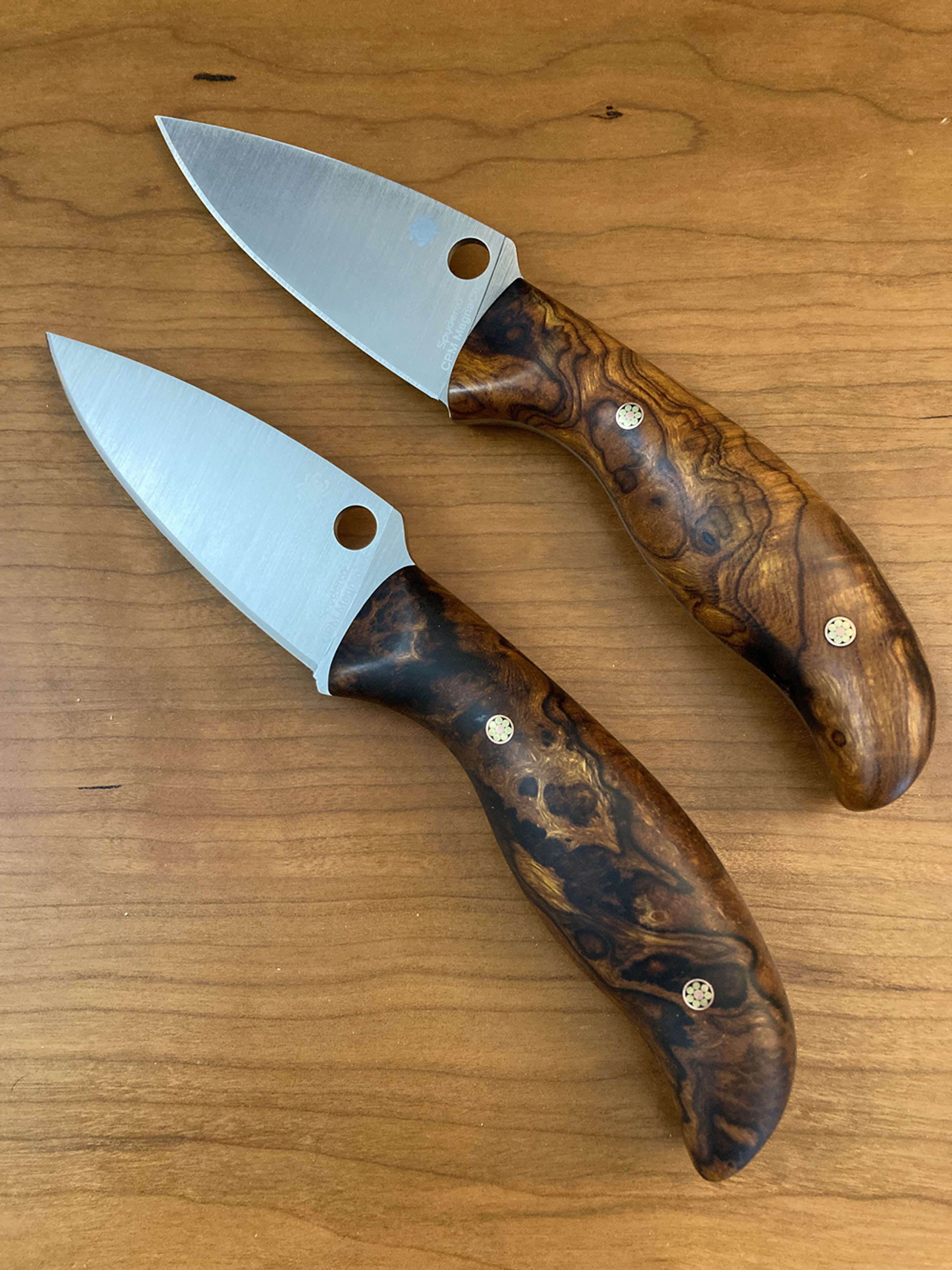

A pair of Magnacut Mules with burl ironwood scales... one was a gift for my teenage son, the other is a gift for me!

Wow! Those are beautiful Capn'! I just recently ordered some presentation grade burl ironwood myself, hope they turn out half that good.captnvegtble wrote: ↑Wed Mar 09, 2022 6:39 amA pair of Magnacut Mules with burl ironwood scales... one was a gift for my teenage son, the other is a gift for me!
How do get that slant at the thumb area close to the blade? I've seen quite a few mules with that and would like to try it myself if it's okay to ask.

Thank you.legOFwhat? wrote: ↑Wed Mar 09, 2022 8:33 amWow! Those are beautiful Capn'! I just recently ordered some presentation grade burl ironwood myself, hope they turn out half that good.captnvegtble wrote: ↑Wed Mar 09, 2022 6:39 amA pair of Magnacut Mules with burl ironwood scales... one was a gift for my teenage son, the other is a gift for me!
Are you asking about the thumb-index finger "pinch" area at the end of the scales?
I used a 1.5 inch diameter sanding drum attachment for my drill press (https://www.rockler.com/12-piece-long-d ... nt-sleeves). You have to sand that slant in before attaching the scales to the Mule, and then refine and smooth it out by lots of hand sanding after attaching and shaping the scales. I took the scales to a 1500 grit.

Thank you for the tips! I'll give that a try.captnvegtble wrote: ↑Wed Mar 09, 2022 3:04 pmThank you.legOFwhat? wrote: ↑Wed Mar 09, 2022 8:33 amWow! Those are beautiful Capn'! I just recently ordered some presentation grade burl ironwood myself, hope they turn out half that good.captnvegtble wrote: ↑Wed Mar 09, 2022 6:39 amA pair of Magnacut Mules with burl ironwood scales... one was a gift for my teenage son, the other is a gift for me!
