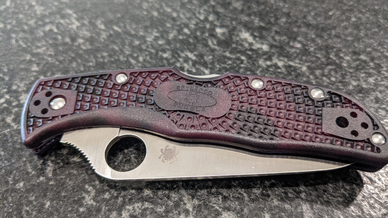

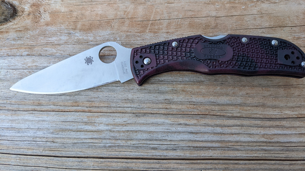

This is my DLT Exclusive Endela. I used the regular formula because I could not find the synthetic. It has held up just fine.
Different lights. It is more purple in real life, but dark purple. Zome can still be seen but very muted. This was with the Royal Blue.
Then I got tired of that and went all black.

Outstanding ! Endela has a nice understated look .MG2JSumm wrote: ↑Sun Jan 16, 2022 4:56 amThis is my DLT Exclusive Endela. I used the regular formula because I could not find the synthetic. It has held up just fine.
