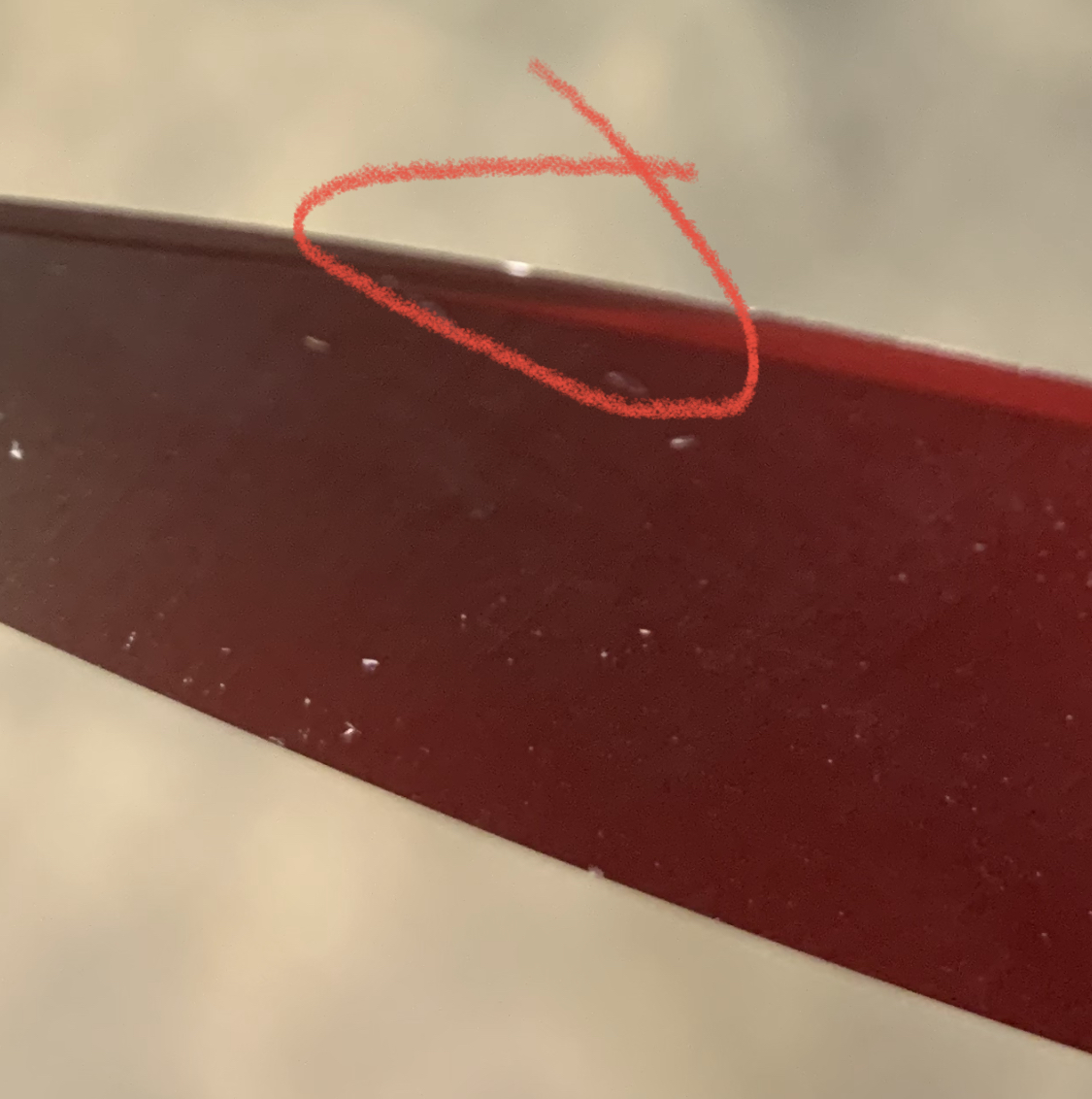

My mule has been on cardboard duty over the holidays. I somehow got a chip - thinking I hit a heavy staple in a heavy duty cardboard water heater box. I could see it from both sides and couldn’t feel that it rolled. Otherwise, it was also getting dull. I used leather strop a couple times during the cardboard massacre which did help.
So - time for second sharpening. I did same as previous post (diamond then shapton 330/1000/2000 then leather strop). I spent very little time on the diamond plate and I couldn’t locate the chip. Continued through the progression and it sharpened really nicely. I’m not sure how many people are using whetstones - I know there is sometimes concern they struggle. I’m having no issues and doesn’t feel like it takes any more time.

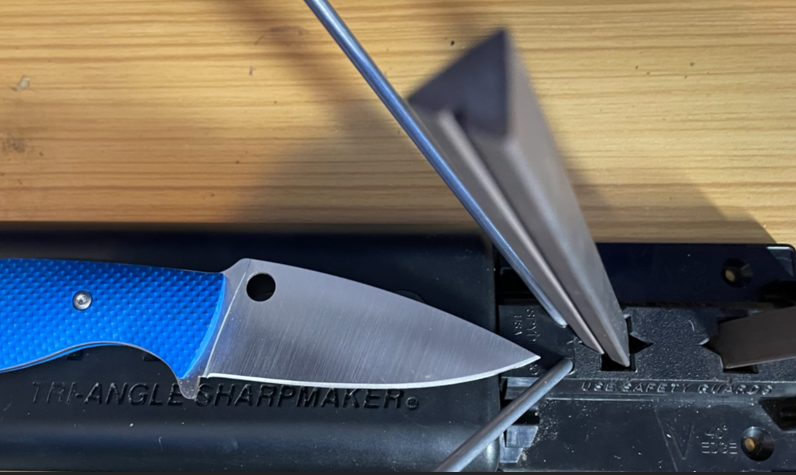

I was lucky enough to score a Magnacut from a gracious forum member. Like always I just started with a touch-up on my Sharpmaker just to clean up the edge. I've used it over the holidays mainly on cardboard due to all the Christmas boxes. So far it is holding a working edge very well. I'm back to work this week but plan to reprofile on my water stones over the weekend to at least see how well this steel can do with a ~15dps edge.

I finally found a need to touch up the Mule on the Sharpmaker. It took a month of use both in the kitchen and cutting boxes. The edge held up very close to what I experienced with S30V. Sharpening was a breeze. It was very similar to sharpening LC200N. I barely needed more than a minute or two of time before getting it sharp enough to accidentally shave some arm skin off lol.

I too am a woodturner and work with some of the cryo and powder steel tools. The tool steels for woodturning tools seem pretty far behind the nice stuff we see in mules and production knives but they will make a good edge with a little work. I sharpen with CBN wheels for actual turning and use some stone wheels just for forming a tool shape. I use several carbide bit tools, usually scrapers, and sharpen the bits with a diamond brick that puts a real nice edge back on the carbide. I use a Trend diamond hone oil and it works well with the carbide. I have been a steel nut for a long time but never really got in to actually having mules to play with until the last couple of years. Have been having a blast with Spyderco since joining the mule team! Now I am making scales and wondering about the super sharpening I read you guys doing. I just use the sharpmaker and the diamond brick so am far behind but have a great EDC edge! I sharpmakered my magnacut for the first time and put better than original edge on it seems, with very little effort. Now more cutting things up!
