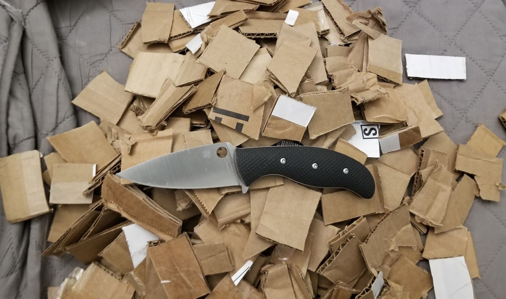

I got my 2 Magnacut Mules in person at the store. I finally got home to take a look after work. Cool! I set one aside to determine what I am really going to do to it; the other got the g10 grips put on that where laying around. I also have a set of the flat micarta scales too.
This morning I decided I better at least use the factory edge before I do my Sharpmaker fun fest to a 30* inclusive edge.
So after a good 40 minutes I had a nice small pile of cardboard to throw away.
Notes on factory edge:
Sharp, duh. It stayed sharp thru the 3 boxes I cut from that start pile, I needed to clean some gunk off half way through that process. By the end it was not cutting paper as cleanly as the start, a little bit of fuzzy on the cut. It still has plenty of life to go, I still have more boxes too. Once the boxes are done I will do what I did with the Z-Max and Z-wear mules and profile this test mule to a 30* edge on the Sharpmaker.
More to rodeo fun to come. Feel free to join in.
I'm going to try to better document my uses with this knife since I didn't do a good one with the first 2 mules I got. I am also going to try to be a little more "scientific" about this one as well since I got 2 of them.

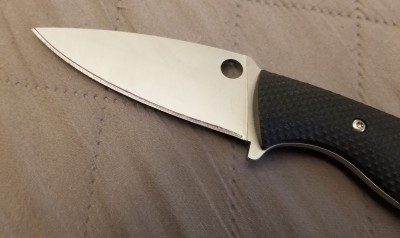

I put my sharpie on the mule to start and see what my angles were and how much work this was going to be.
I made light passes on the CBN rod, to my surprise it was nearly bang on with the 15DPS side on the Sharpmaker. So I continued to make light passes for a while.

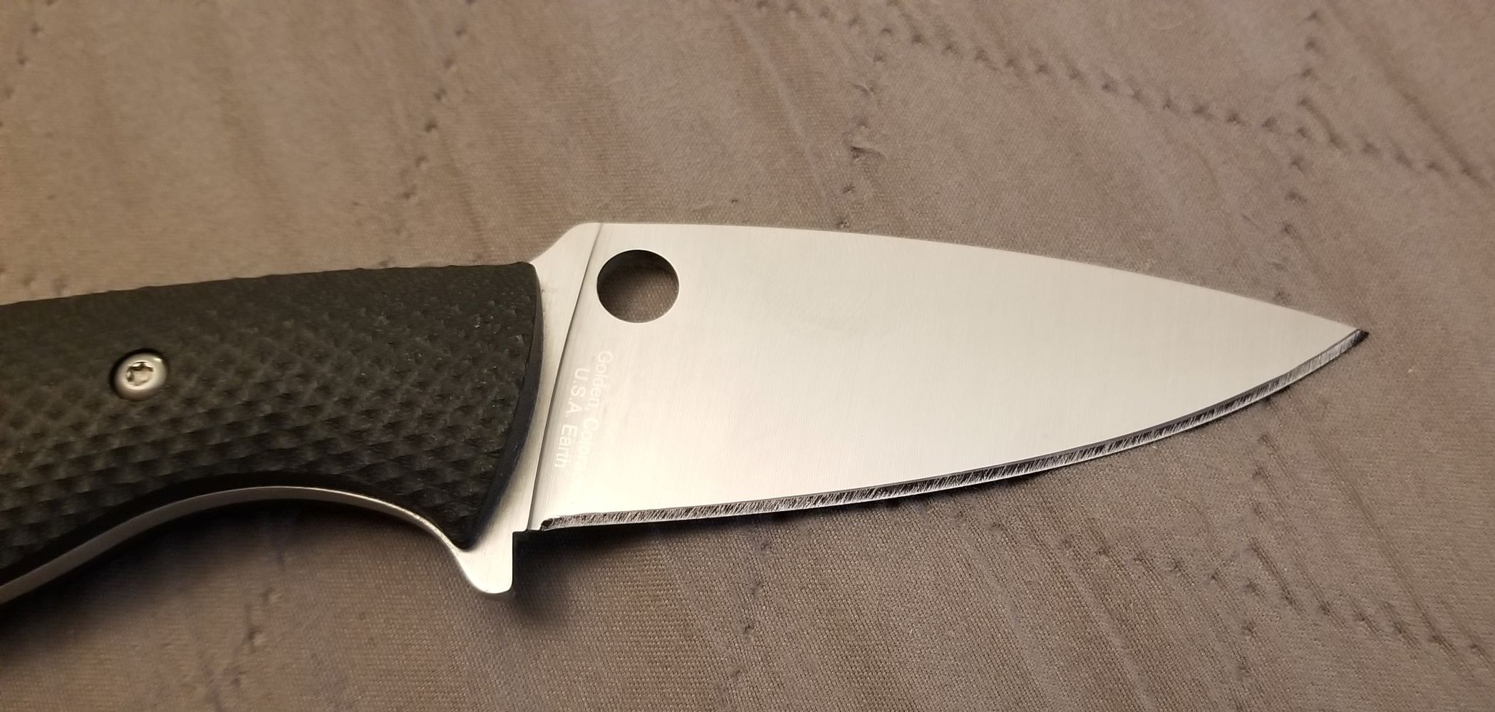

After a couple of shows worth of that I noticed that the bevel is really a little less than 15DPS on the factory edge and that I am really putting a nice micro-like-bevel on the edge. It got sharp really fast, honestly I probably could have put it on the brown rods for 10 minutes and been good to go. But I like going too far typically.
This bad shot through the loupe shows the edge coming along.

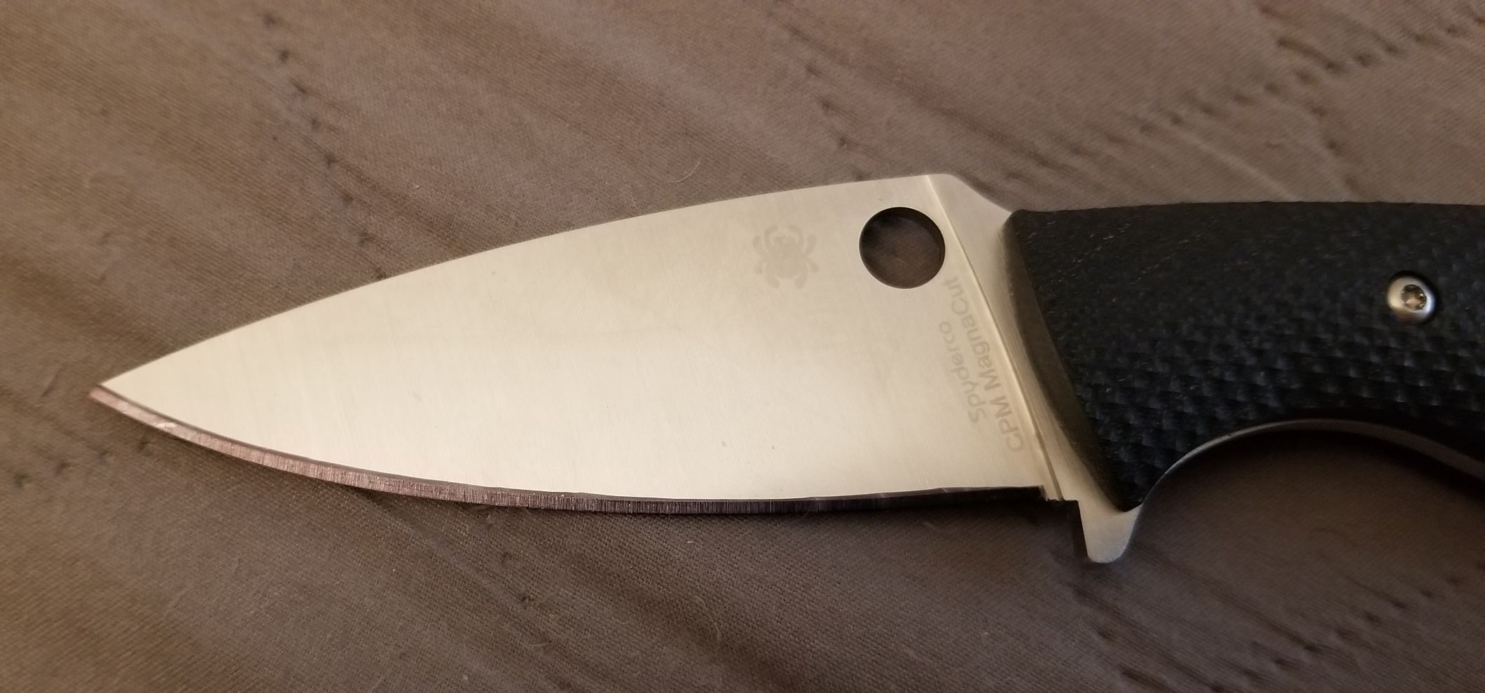

Where I stopped last night. After some brown rod treatment.
I used the factory edge up and could not cut paper cleanly or shave arm hair before I went to sharpen it. Over the course of the day yesterday and a bit this morning I spent maybe 1 hour to get to where I can make paper curls, it shaves hair, and is sticky sharp on the skin. It matches my other edges on other knives.
Magnacut on the Sharpmaker CBN rods feels really good. It doesn't feel like it is skipping over things like harder steels like my Z-max mule. It has a nice even scratch that gets put into it. Takes a super fine edge too.

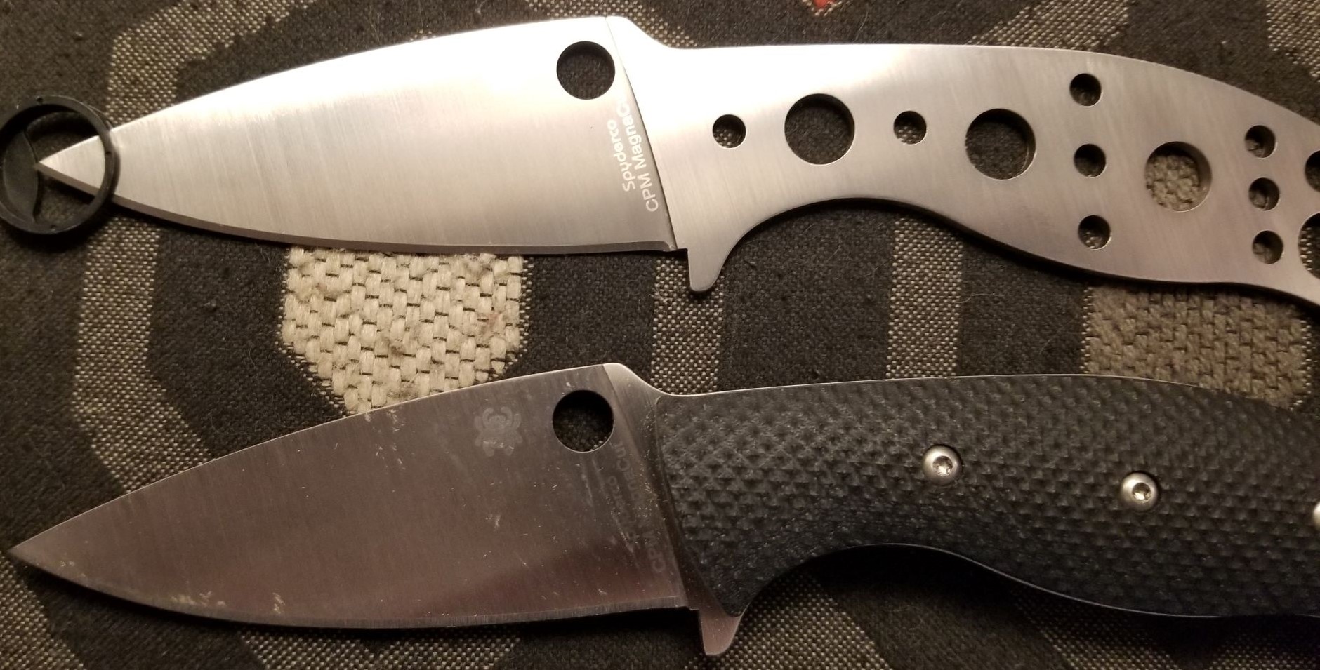

Comparisons to my 2 other Mules on the initial sharpenings:
Z-Max - well this one had one bevel that needed major reprofile. On the Sharpmaker that was a LONG while to get it down. Once I got it down and then worked to the apex and hit that, this thing has stayed wicked sharp. Not hard to get sharp, just takes time on the system I have. Magnacut is much faster and even easier to get the edge I like on it compared to Z-max, obviously. The comparison here will more likely come from corrosion and edge holding in kitchen scenarios, so more to come from that.
Z-Wear - My sample felt a bit harder than my spyderco cru-wear knives. I think it was the factory edge because now it feels much more like the cru-wear I have. It sharpens easily. Takes a great edge. I think Magnacut was a bit easier to deal with and took a finer edge with less care on my part to do so.
