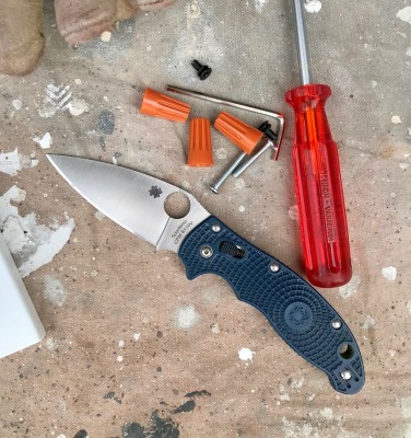

Posts: 6148
Re: Optimal inclusive angle for S110V
Not to be all "#me too" here, but I also have been running my S110V Manix at 15 dps (no micro bevel) for house contracting work. Yes, lots of wood carving and anything else that comes up. No visible chippies yet. It did need a resharpening after 8 weeks of contractor work. Also, I did lose the very tip (a fraction of a mm, almost not visible by eye...can you see it below?) due to accidentally running the tip into concrete, but...that's to be expected and the blunting sharpened out easily.
Have really enjoyed how sharp the S110V stayed for 2 months of work. During this time I probably went through a dozen blades in my ute knives. Was expecting S110V to be more delicate than it is, but having used it awhile, I treat it like any other steel at this point, I don't baby it like I used to. (Granted, I don't run it into nails, either! That's what the Hackzall is for...!)
Also really appreciated the light weight and flat profile in my pocket. I can carry a much larger knife without discomfort or even awareness, when it's FRCP or FRN handled. I usually carry a Caly 3 but the FRCP Manix 2 didn't "feel" much larger due to its low weight.
