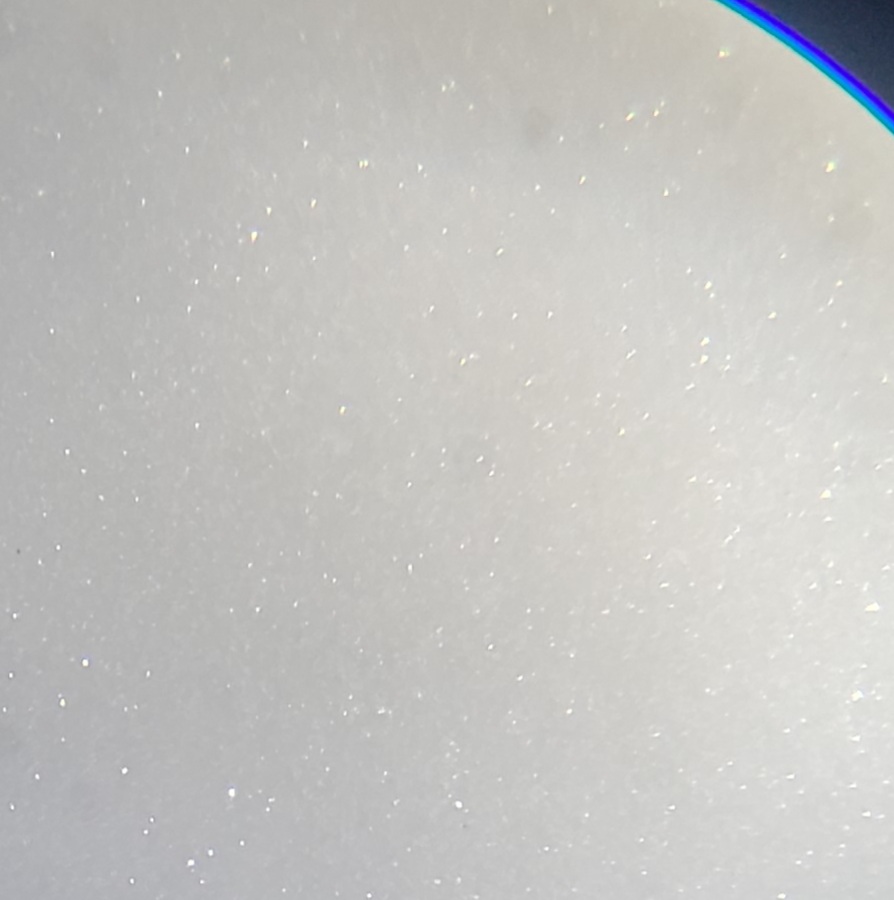

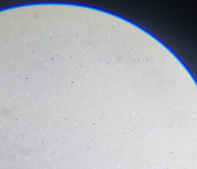

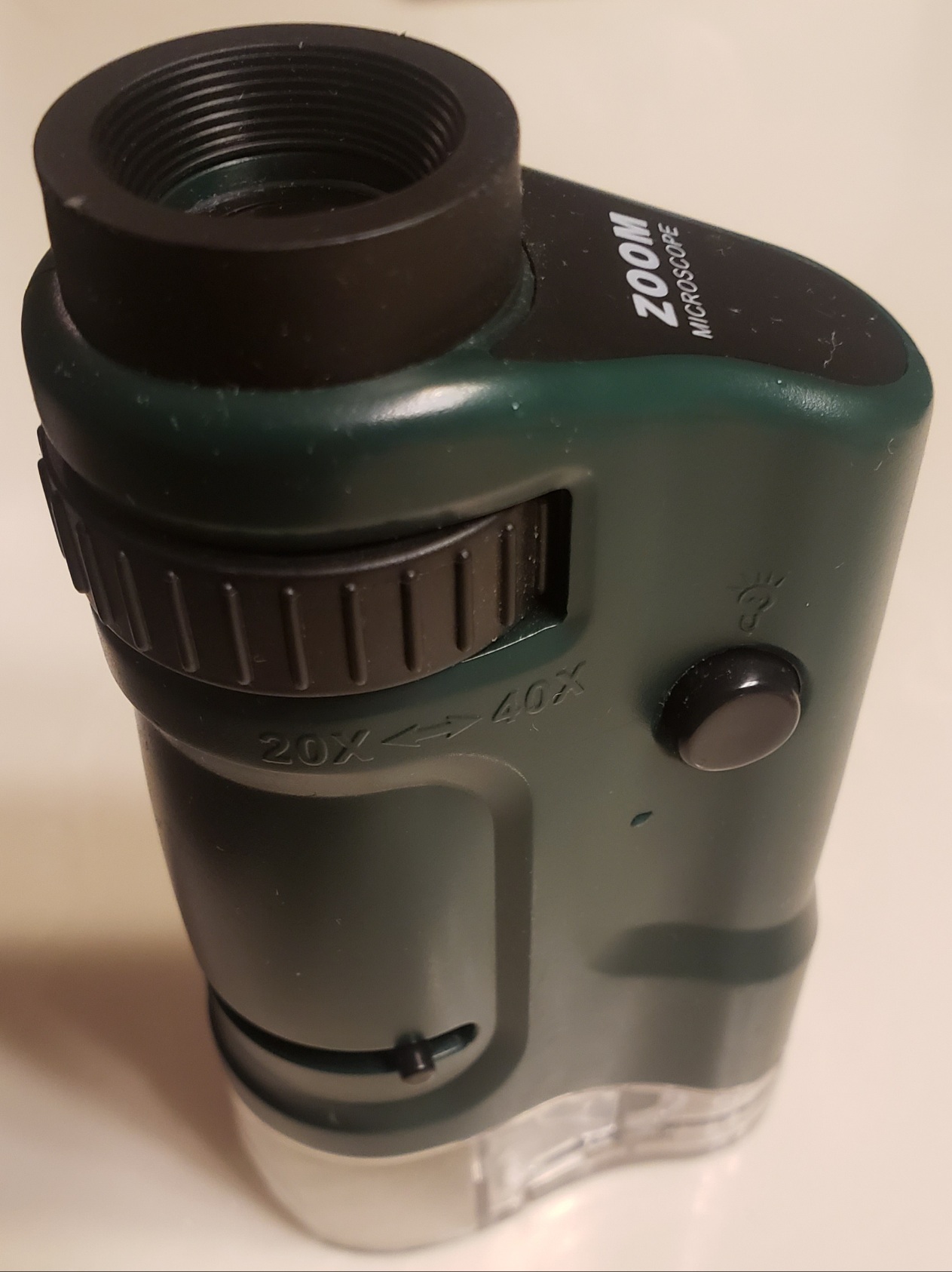

Thanks for your suggestion, I've used simple 20x-40x microscope to take some pics for you.
Great idea as it revealed something I had been unaware of, it appears some of the lapping grit stayed bonded in the UF stone, mind you the stone was cleaned with BKF about 3 times after lapping and has been rinsed throughly number of times.
There is visible black dots that must be the remnants of lapping grit. Does this mean my UF stone is ceramic/SiC combo stone now? That explains why it cut faster than the factory side.
My bevels are not great and I have long way to go to get them straight, nice and clean. This is Sage5lw in CPM S30V steel.
Re: More about the Spyderco UF stone. Good stuff.
Yes, the black particles are SiC however, they are most likely much finer than when started. The distribution is very small and I believe would not contribute much to actual sharpening time. The SiC contamination does result in deeper scratches on the bevel.
