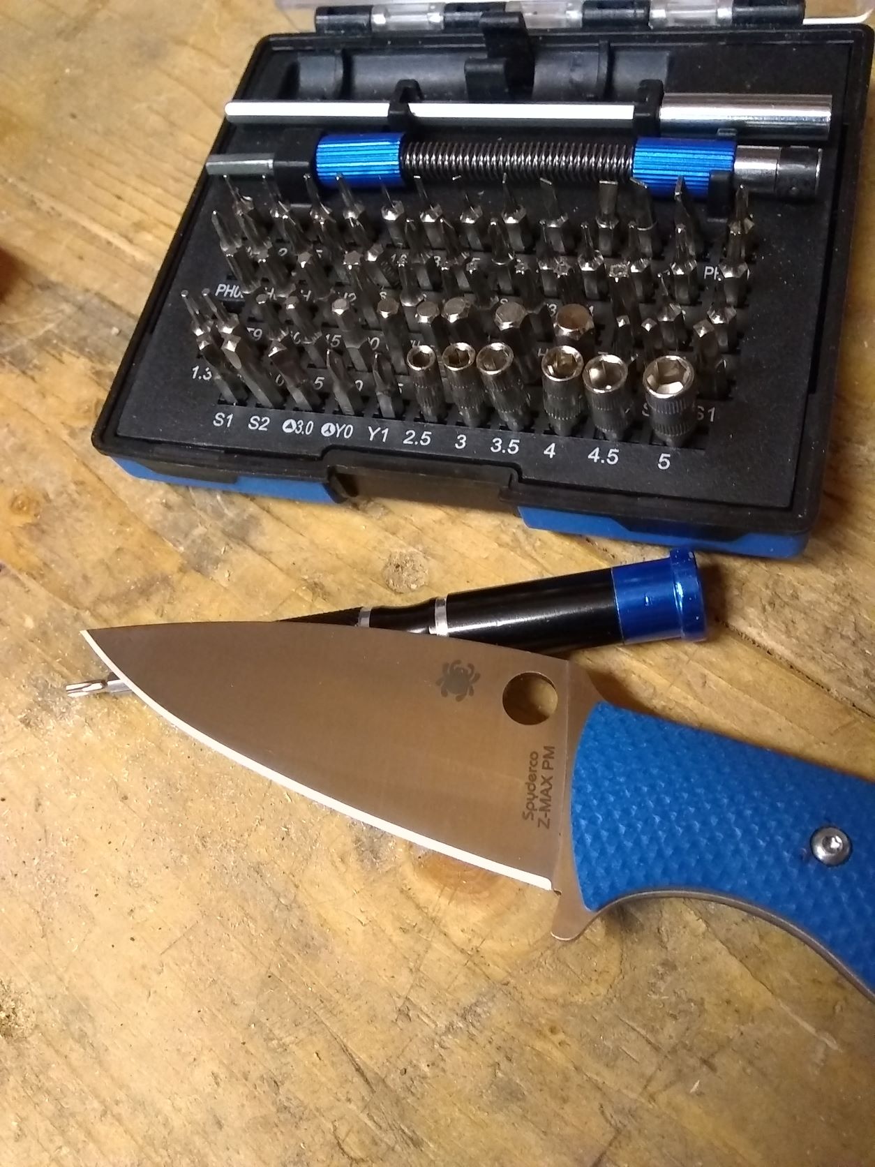

Lucky guy. Scored a Z-Max Mule.
Halpern Scales.
And, a fire hose.

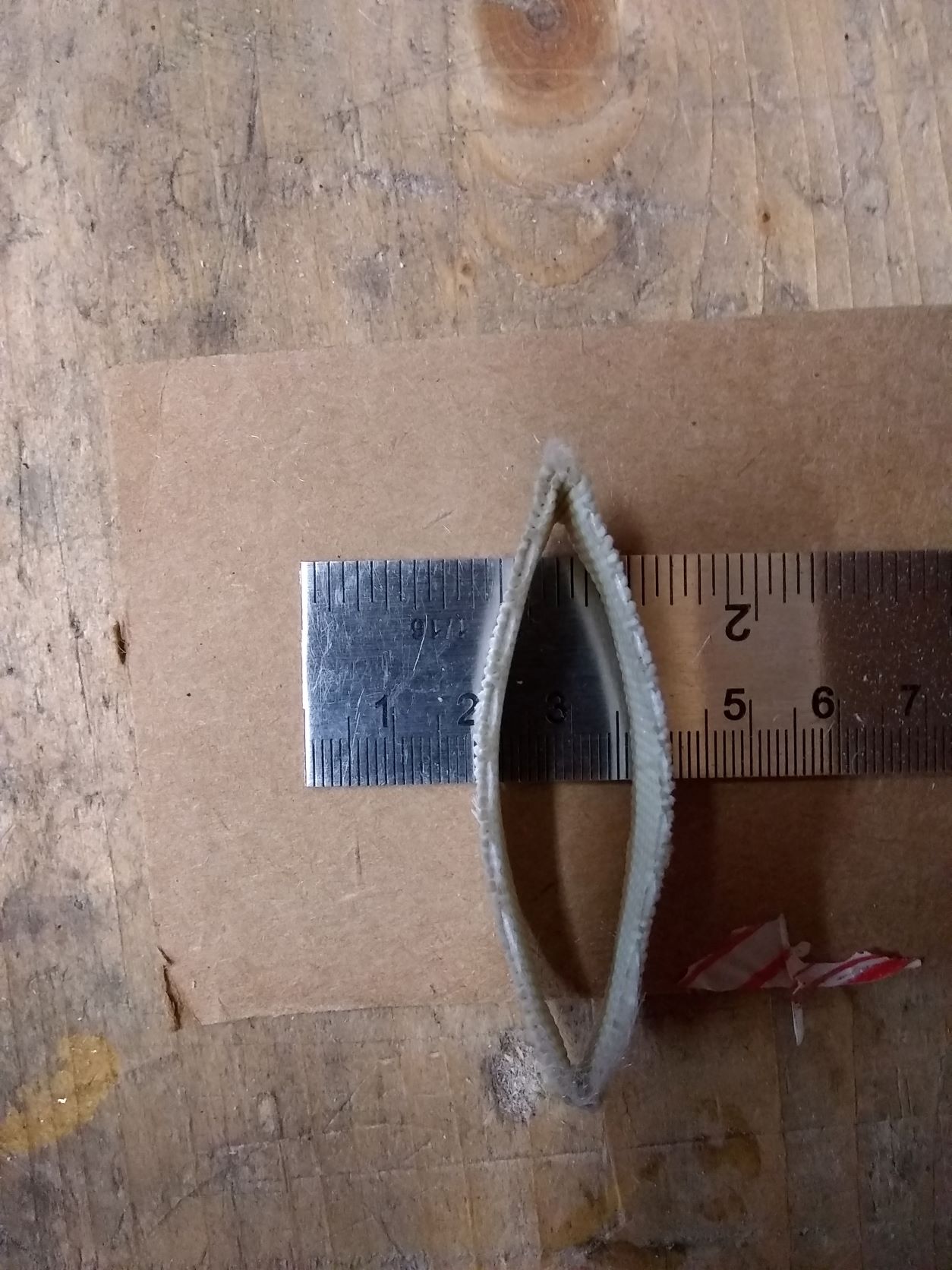

The hose is 2.5 inches wide single wall, tubular webbing, with some sort of plastic coating inside for water proofing. The walls are 2mm thick.
I held the hose with a pair of pliers and tried to do push cuts from tip to heel of the blade.
From left to right, the first and last slice. I tried to curve the cuts to make the blade cut more fiber and not just slice through the grain.
I totaled 287 cuts. It was easy until 167, around 80 it stopped shaving hair cleanly, 200 it was hanging up on paper. 220 it was not push cutting tip to heel. I adjusted and pushed and pulled, tip to heel and back again and the blade kept going to 280. Around 280ish it started getting hard to cut, and was no longer fun. I tend to test edge life by sticking the edge on my finger nail and trying to push the blade sideways, when it sticks and does not move it is sharp. At 280 it was slipping off my nail with no effort, aka dull.
Meanwhile, nice pile.
This hose was decommissioned and has been tensioned around trees to make a slack line, we have pulled vehicles with it, and generally used it as a kids toy. It is dirty and has been ground into dirt and tree sap. At the time of testing it was gritty and sticky in places.
Sharpening details later.
