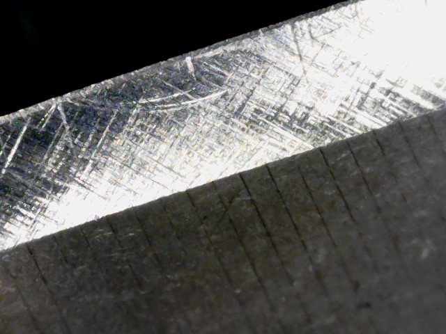

For those interested this is what the 14usd 1600x Ebay special microscope will at least get you. This picture is of a Maxamet PM2 before sharpening. This was slightly out focus so with practice it could get better.
cabfrank
Posts: 3547
Re: If you are NEW to sharpening, or having DIFFICULTY, YOU NEED TO SEE THIS THREAD
#63
Post by cabfrank »
Impressive. I fear going further down this rabbit hole.

Nah lol. A lot of this stuff is so affordable it's almost silly to not have it as a standard part of your sharpening gear. Any time I'm sharpening something and it seems like I can't get anywhere, this is my next step. I don't use it in regular sharpening very often though.
