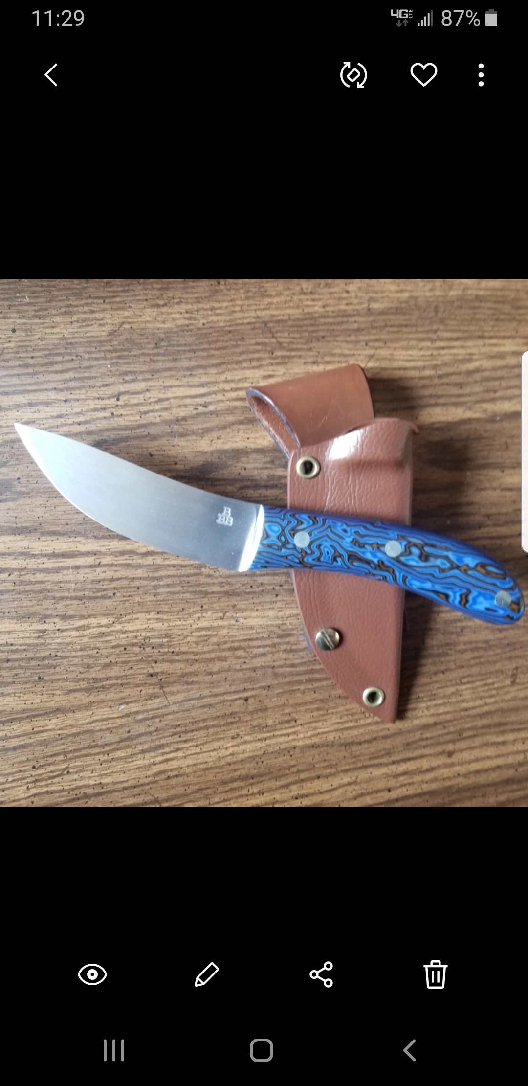

This is a custom trapper i bought from triple b in m398. I usually grab the other custom i own of his much more than this one truth be told. However this is a full handmade custom, so the heat treat, geometry, etc shouldnt be compared to production capabilities imo. I would like to do side by side comparisons to see how spyderco is heat treating this steel when the time comes. I will try to score a mule when possible if spyderco makes it. And i get the opportunity to purchase one before they sell out.
