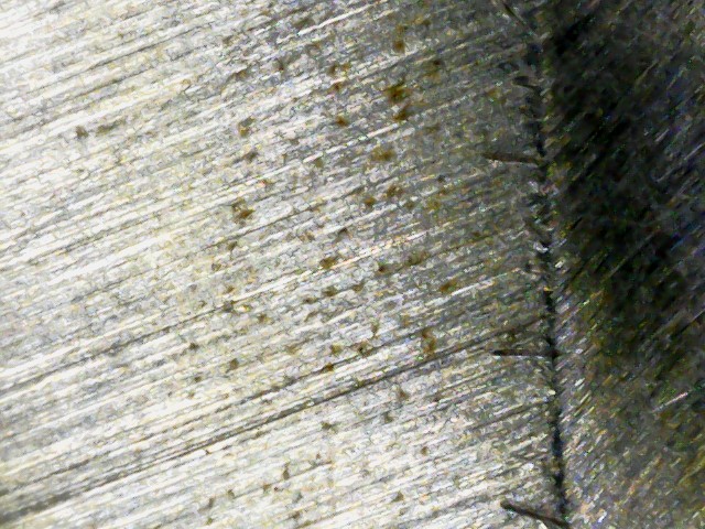

It's been a very humid week in the Great Lakes region where I live. I thought my knives where doing good, that is until today when I got out my Ukpk in BD1N. There's a small section on both sides that has red rust spots.

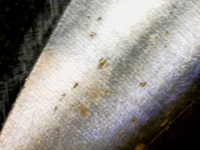

After finding that I decided to check my other knives and found my PM2 Maxamet with pitting and surface rust. I don't remember cutting anything corrosive, it's just a small area that looks like a smudge. This finding made me pull out my usb microscope to see how bad the pitting was.

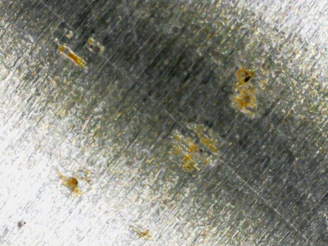

I also checked out my other knives and found rust starting on my CTS-XHP Chap. The blade looks corrosion free to the naked eye but under the microscope you can see it starting.
I'm new to knife collecting so this is the first time its happened and I'm not sure what's the best course of action. I have a few different oils(vegtable,mineral,3in1,wd40,lansky honing oil) but nothing specifically for this. I would prefer it to be non-toxic/food safe so I don't have to clean it before use. Anyone have advice on rust prevention in humid climates?
