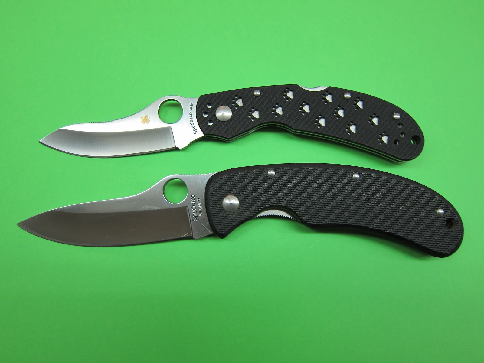

Heres an example of a straight / neutral blade - the Protech Godson - which is a modern version of the classic Italian Stiletto.
Behind it is the Spyderco Ayoob - one of the most extreme Negative Blade Angle (NBA) models Spyderco has ever produced.
If we imagine pull cutting (say, slicing open a box or slicing through carpet) you can see how much more you need to bend the wrist to put a straight knife's edge into the material.
