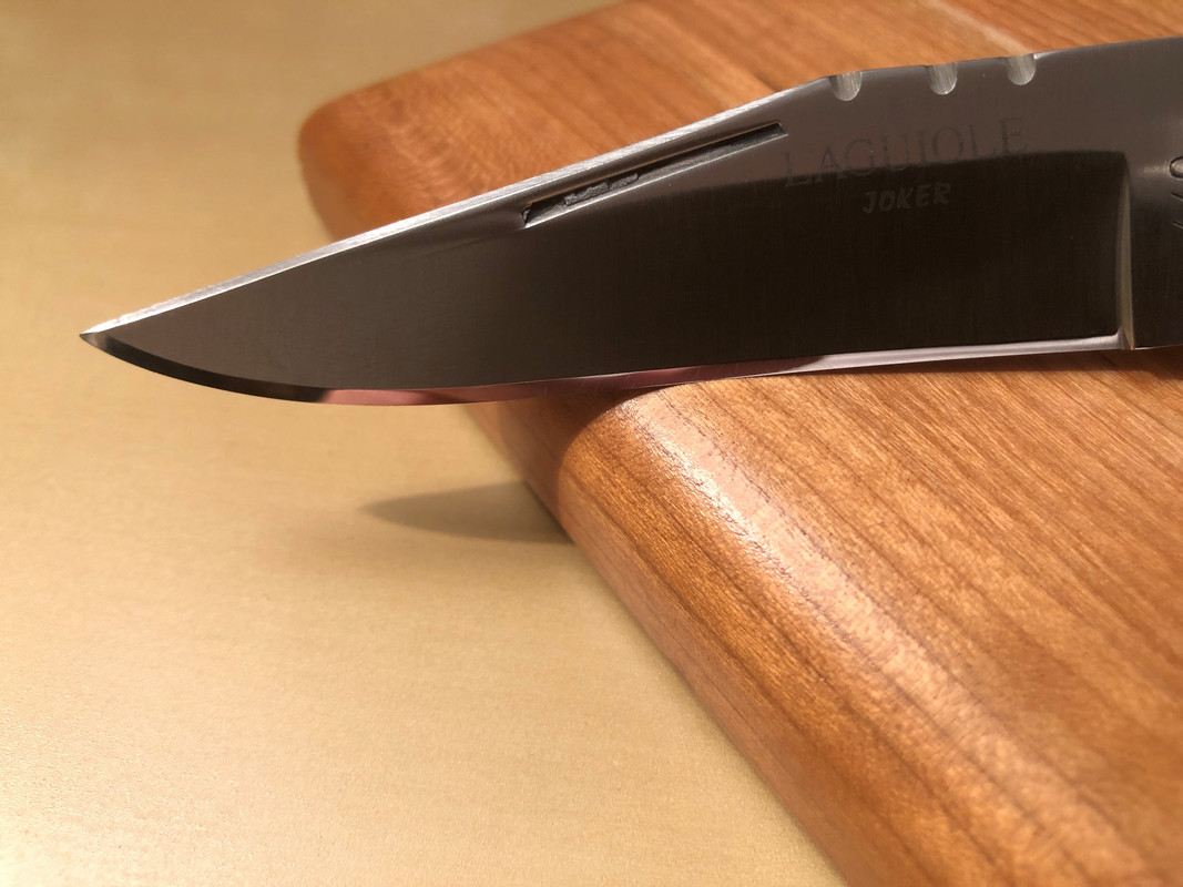

Believe it or not, that Millie was the first (really) expensive knife that I bought in 1999 (we loyal European Spyderco customers pay in average an additional 30% for VAT and custom duties). I call it the "starter" of my collection.
Thanks to your help, I can now attach pictures in a decent size (I would like to introduce you to some of my Spydies). I sincerely thank you for that!!!
