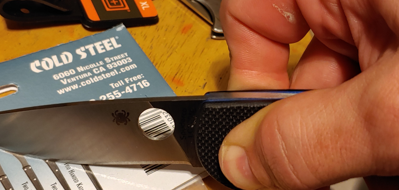

Posts: 16923
Re: Siren - strange lock movement
Well I tried again using more force and it seems mine does do it after all. I never put this much force on a folding knife with my grip so far behind the pivot so I've never noticed this behavior. Very strange seeing the lock release go down like a ghost is pushing it.
JRinFL
Posts: 6151
Post by JRinFL »
Mon Feb 15, 2021 1:39 pm
My thoughts exactly. It really is disconcerting when you feel the lock drop away.
FTR, mine is much worse than yours in the picture. I don't feel comfortable using it at this point. This is sad because I love the design and how it fits my hand.
