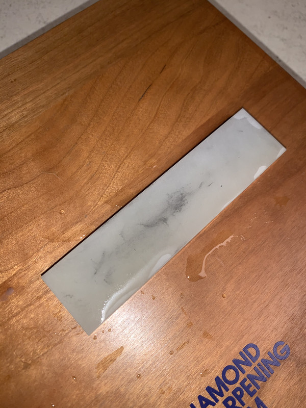

Hard to illustrate, but this is a wet translucent Arkansas stone. It has a milky opalescent effect. They’re really pretty and interesting to use. I want to get the UF stones for my sharpmaker.
