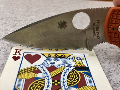

I challenged myself to get my Aqua Salt shaving sharp off my 200 grit plate tonight.
To start it had a fairly uneven bevel in the 10dps ballpark, with a microbevel that had grown thick ground at 15dps.
First I reset the bevel holding the knife about as close as I could get to flat to the stone, without touching the top of the hollow grind. I started out grinding each side until the bevel looked reasonably flat and I raised a burr, then finished with alternating strokes to minimize the burr.
Then I did about 3 feather light strokes per side at a more obtuse angle, a little under 15 degrees per side.
No stropping. Fresh off the coarsest diamond stone I own:
https://streamable.com/conwn8
Here I am attempting to shave arm hairs with this edge:
https://streamable.com/jcqv1q

Nice job. I have found it quite difficult to get a clean, keen apex off of my coarse stones. I think what I'm missing is the ultralight pressure strokes at the end, but it certainly is challenging either way.

Been going through my collection and converting all but a few special use knives for low grit edges.
Tonight I did my Street Bowie. 200 grit diamond plate for the bevel at roughly 12dps, then I switched to 300 grit for a roughly 15dps microbevel, then stropped with 7 micron diamond paste twice per side. Hair popping sharp and slices very aggressively.
I've been testing my edges on plastic shopping bags instead of paper lately. They give me a good idea of how refined the apex is by how much effort it takes to initiate a slice into them. Poorly formed edges require holding the bag with tension to help start the cut. Coarse, well apexed edges don't care about that and bite right into it.
On deck I have my M4 Manix XL, S110V Para 3 and Siren, all set to get similar edges.
