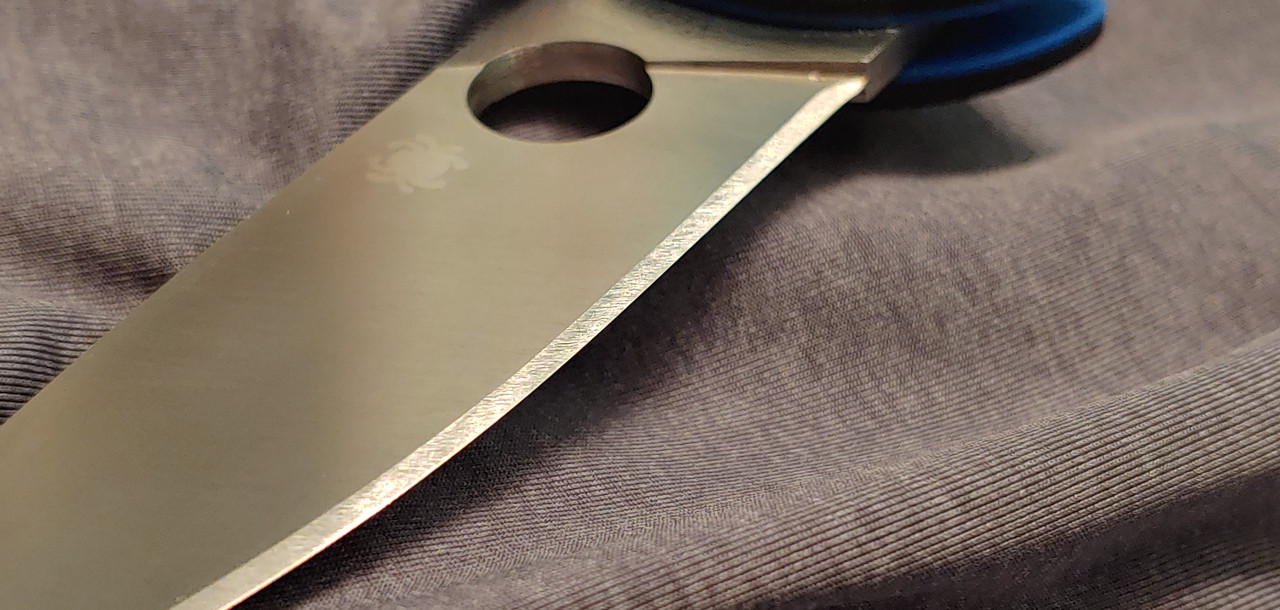

With the weather cooling off I wanted my Police 4 K390 ready to go. The edge it had was pretty bad, it had been used until it was really dull.
I reset the edge on a 300 grit diamond plate. Once I had a burr coming up on either side, I switched to a lighter pressure and deburred as best I could on that stone. It could scrape shave. Then I gave each side a few passes on a strop loaded with 7 micron diamond paste.
It's a very aggressive edge. I tested it out on some rope and plastic wrap and it really bites into materials.
This will contrast nicely with my polished VG10 Police 3 optimized for push cutting. My VG10 Police 4 Lightweight is ground on a DMT coarse then given a microbevel on medium spyderco stones, so it falls it the middle.
