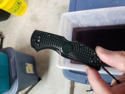

Salt 1 green fade and native 5 salt forest green.
Both vinegar, water, and black (normal) rit dye liquid. Has to be boiling and it does not take long. The fade was probably less than 30 seconds total.
I took the native all the to black, but to get to forest maybe 1-2 minutes. Just dip a few seconds at a time and rinse. Repeat until shade you want.
*note it would not take the dye worth poop until mix was rolling.

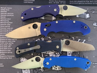

A reference picture. Dyed the Manix XL (natural jade g-10) and Caribbean in Sapphire Blue. I wanted them dark blue so left both in for extended period of time. The native 5 is the blurple S110V and the PM2 is the Smurf Blue M390, both included for reference.

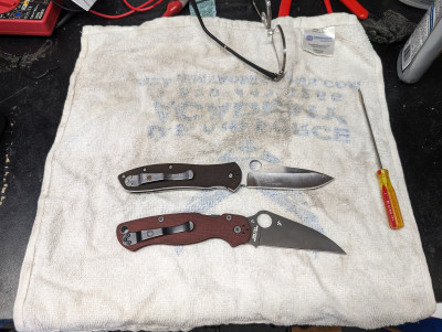

I tried out a dye job on my Bradley folder and the Cutlery Shoppe PM2 exclusive. The Bradley had natural G10 and the PM2 had the orange scales. I went with the Rit Chocolate Brown. I thought the brown and jade green on the Bradley would combine to make a brown with greenish tint. I wasn't a huge fan of the hunter orange scales on the PM2, and I thought the brown would result in more of a burnt orange color. Well, the Bradley just ended up dark brown, and the PM2 lighter brown with a hint of orange.
I think if I had taken them out of the dye earlier I might have gotten closer to the color I wanted. It seemed to resist taking on the color for quite awhile and then took it up very quickly. The other option would have been to mix in another Rit color according to their formulas. They have a bunch of color combination formulas on their website. Overall, I am happy with it. I like more earth-toned colors so that was achieved.
I got the dye from hobby lobby for $5. I picked up a stainless steel pot at the thrift store for $2 so it's not expensive. I did use the whole bottle of dye. I used tie wire to make a rack that could suspend the scales in the pot. I didn't want them to touch the bottom in case the heat damaged them. I threaded a long piece of wire through the holes on the scales to make fonduing them easier.
