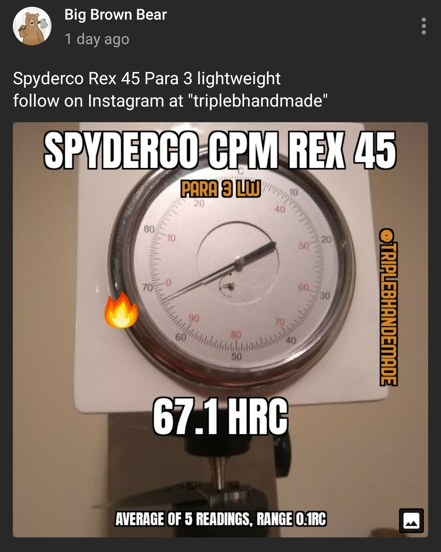

#123
Post by Albatross »
And another from BBB...
Posts: 4673
Joined: Mon Nov 09, 2015 3:40 pm
Re: HRC Database
#124
Thanks!
The Meat man
Posts: 5856
Joined: Wed Jan 03, 2018 8:01 pm
Location: Missouri, USA
Re: HRC Database
#125
Post by The Meat man »
Awesome! Thanks BBB and Albatross for sharing!
Good to see a higher number for the CPM 10V.
And that REX 45 - incredible! :eek:

emanuel
Posts: 303
Joined: Tue Mar 20, 2018 7:51 am
Location: Romania
Re: HRC Database
#126
Post by emanuel »
The Meat man wrote:
Sun Mar 29, 2020 9:07 am
Indeed, for people that don't like high carbide steels, Rex 45 is the peak their should strive for. Amazing steel in a high polish edge.
