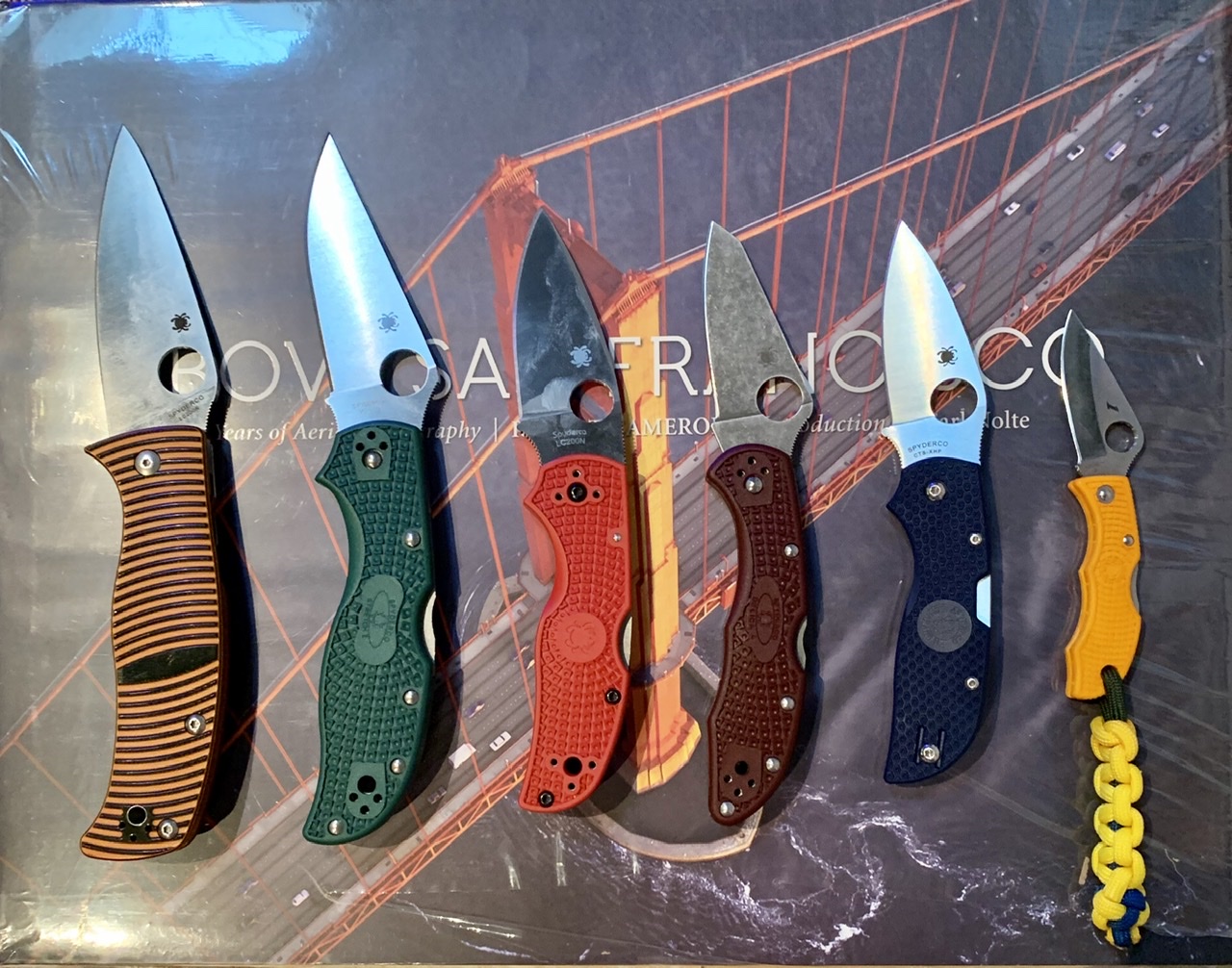

FRN UKPK. Previously modded with smooth natural g10 “jade” scales from Cuscadi. Dyed today in RIT DyeMore Peacock Green for 10 minutes. I may do another round and go slightly darker.

Mine have all been simple single color jobs. The more I do, the less I overthink it. I used to submerge in boiling water but then I'd worry about the knife hitting the bottom, found I get results just as thorough dumping boiling water into a cheap plastic coffee mug from a gas station and soaking. Every couple minutes I'll swap the blade from open to closed so there's no missed areas around the pivot. A leatherman/pliers are handy to move the knife in and out of the mug. Here's a simple black dragonfly that I wanted in a more subdued color for use in public. Black is the easiest choice- no need to worry about soaking too long, just drop it in and come back in an hour.

The salts have definitely come out best in my limited experience. Of the three I've done all came out the exact color of the box used, whereas the gray delica went maroon in the same red bath as the native and the Ivory stretch was done in teal but came out forest green. The gray frn chap took navy blue surprisingly well.Doeswhateveraspidercan wrote: ↑Wed Dec 18, 2019 3:42 pmThanks that is a very nice consistent re-color.

I tried to do a dark purple on the chap lw I had, but I couldn't get it darker than a lavender color, soaked maybe an hour. I think i just used the liquid RIT, boiling water and vinegar...did you add anything else to the mix on that one? Longer soak time?DTPrime wrote: ↑Wed Dec 18, 2019 5:27 pmThe salts have definitely come out best in my limited experience. Of the three I've done all came out the exact color of the box used, whereas the gray delica went maroon in the same red bath as the native and the Ivory stretch was done in teal but came out forest green. The gray frn chap took navy blue surprisingly well.Doeswhateveraspidercan wrote: ↑Wed Dec 18, 2019 3:42 pmThanks that is a very nice consistent re-color.
