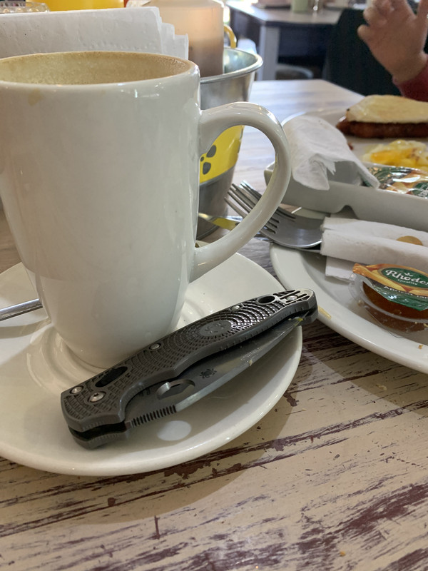

So I did use it a bit over the weekend to process some meat and to eat with.
I was intrigued at how fast it started to slightly discolour. Faster than M4.
After eating it did dull on the plate of coarse. Since I was not at my house there was an inexpensive AO stone and a crock stick set.
I did 20 passes per side on the stone's fine side with the factory angle and then 10 passes per side on the crock sticks (20 dps)
Some notes
- The stone cuts slowly, I did not remove all the factory scratches, however the edge still formed and I could start shaving.
- After the crock sticks it would shave, pop hair and whittle beard hair.
- It formed a nice crisp edge as there was little burr formation.

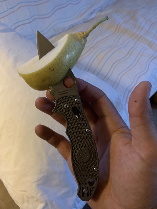

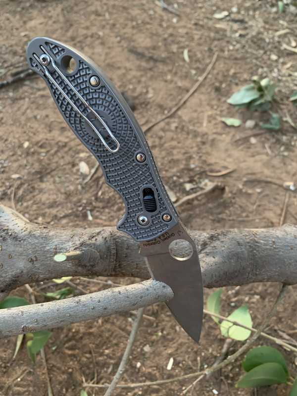

Additional work and thoughts.
The knife went on a camping trip and also went through several sharpening sessions on the trip. A mixture of diamond, medium, fine, ultra fine Spyderco rods and a Norton AO stone. I had little issues with the steel on all media.
It was also used to dig up roots, something most of my knives see as part of their use.
Digging up roots does damage the edge, no surprise there, but I did not experience any severe chipping. Only edge deformation was due to folding.
I have also used it to deburr titanium in the shop. Here is a small piece that I scraped out from the pivot after cutting raceways for thrust bearings.
After some hand sharpening on the diamond stone as time passed I managed to reshape the edge and went through the following grits. 320, 600, 1200, Spyderco UF stone and the results are below.
I am enjoying Maxamet quite a bit.

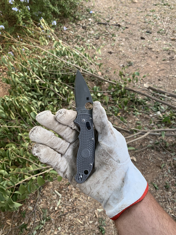

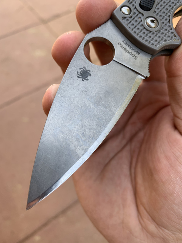

A followup post of the Manix 2 Maxamet.
I have used the knife om the shop similarly to most of my users to deburr Ti, cut sandpaper and clean out backings of belts.
The knife has been edced and handled everyday tasks including garden work.
I have pushed the angle to its extreme for this steel (7-8 dps) and started experiencing some minor edge damage. I stabilized the edge at 12-15 dps.
Maxamet has surprised me.
- Little burr formation
- Far more stable than I anticipated at lower angles
- Does patina giving it some character
- Maxamet does keep an edge longer than most steels in my uses. Especially for a production product. The one thing that still blows everything out the water is a custom K490 piece I have.
