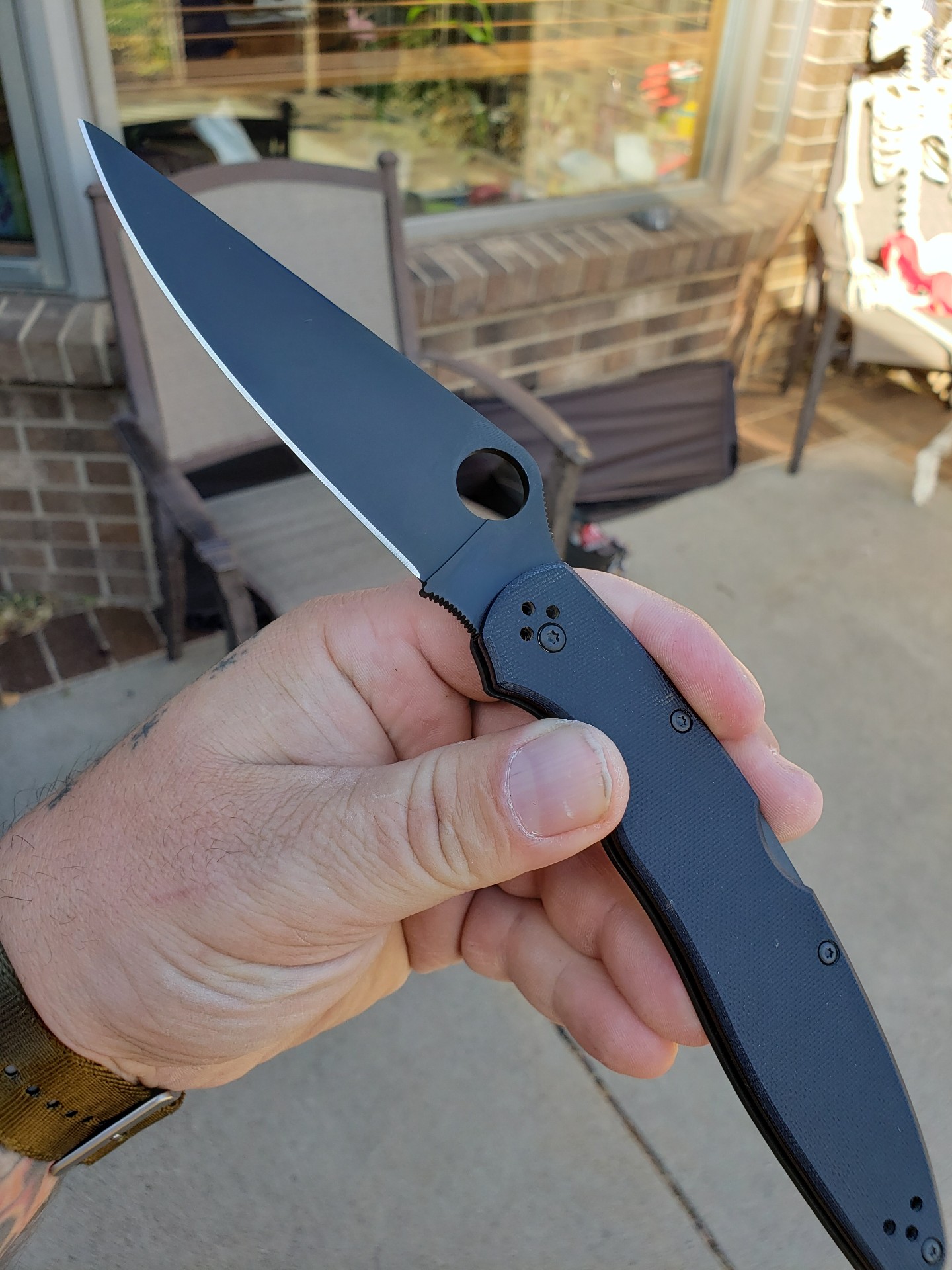

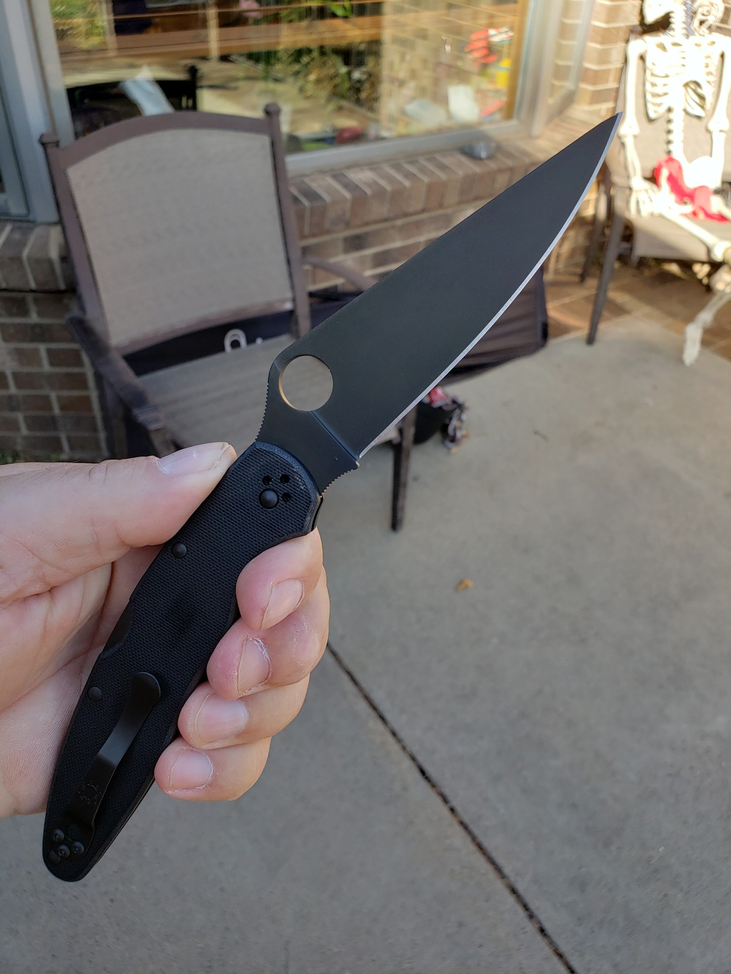

The P4 DLC job I had https://www.razoredgeknives.com/ do is completed! I don't have it in hand yet, but when I do I'll give you some shots of the liners.
Posts: 17037
Re: Let's take a look inside my Police 4
#65
oh man...that looks really good!
VashHash
Posts: 5068
Location: Louisiana
#66
Post by VashHash »
That DLC coating came out really well.

I was going to order a Police lightweight last night but I held off after seeing this update. I might send my G10 P4 in for the same treatment instead of buying a new knife. This would end up being my most carried knife if the DLC works as well for corrosion resistance as it does on my Manix XL.

Well I got it back today and it was so worth it!
Enactive
Posts: 2296
#80
Post by Enactive »
marty_bill_ wrote:
Fri Oct 18, 2019 3:42 pm
Well I got it back today...
Wow that looks good. I don't usually like coated knives, but that backlock and H tho! :spyder:
Holy smokes! :cool:
Presumably, he masked the lock interface?
