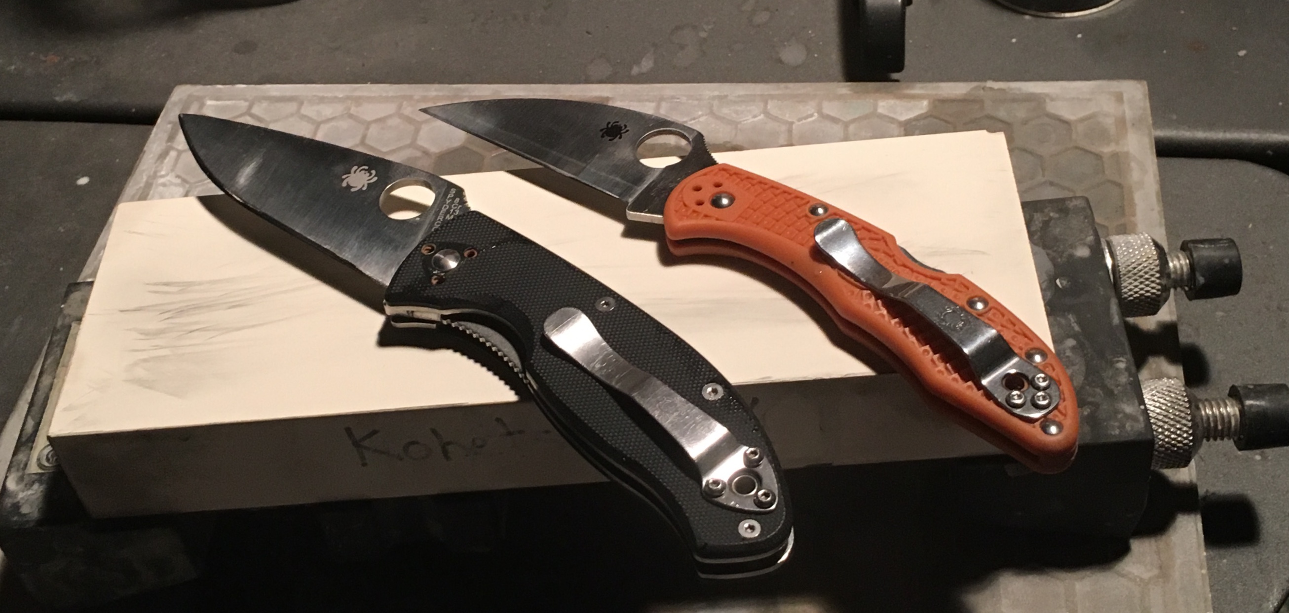

Just finished touching up my Tenacious and Hap40 Delica on a Kohetsu 2K stone.

Pelagic wrote: First time actually sharpening (re-profiling) the Shaman. I didn't have much time so I didn't want to drastically change the factory angle. I probably dropped it back a degree or so. Used my new stone holder and locked in a 325 grit DMT bench stone. After about 5 minutes of light passes and occasional back/forth motions to target certain areas, I had a burr along the entirety of the blade and switched to the other hand, constantly keeping the apex facing me. The other side only took about 3 or 4 minutes. After one round of 3 passes per side I went to 2 passes per side for about 2 minutes. Finished with 3-4 minutes of light alternating passes. Checking the blade on arm hair, it wasn't sharp enough to absolutely treetop lots of hairs. It could however catch on the hair (lightly gliding the blade about 1/4 inch above the skin, it would occasionally touch a hair and stop the knife from moving). This was good enough for my current goals. I moved onto a 3 micron leather strop, and noticed a small amount of burr near the tip that eluded my observation. I decided simply to strop until it was gone, which totalled 5 light passes per side. It was now treetopping quite a few hairs. I went straight to 0.1 micron on leather to give it something extra. After 5 passes per side it was treetopping many more hairs than before. Edge was very sticky and this blade in particular seems to take an above average edge for s30v. Both strops were loaded with a mixture of diamond compound and diamond powder for added cutting speed. The result was extremely sharp, but I feel that I removed more of the teeth created by the first stone than I normally aim to. I'm fine with this however, the edge is just a bit more refined and still slices extremely well.
Thanks for the detailed rundown, Pelagic - yeah I run a similar edge on S30V at the moment - a coarse edge, finished with a very light touch, then a few passes each on 3, 1, 0.25 and 0.1 um diamond and CBN strops.
Am I right in thinking that you don't tend to take your Shaman out to work on the boat? It'd be interesting to compare the stropped edge on the abrasive materials you cut out there, compared to a straight 325 grit edge without stropping.
