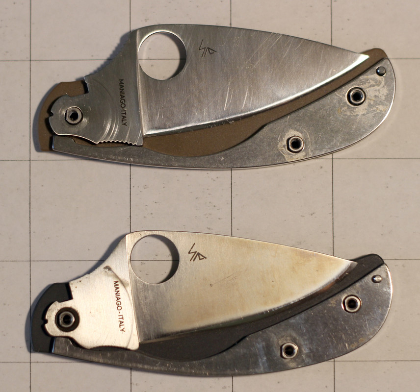

As pointed out by other comments, they over corrected the issue and the blade is almost exposed. After a few sharpenings the tip could be exposed.

Here's how they look now. Both in good working order.

FWIW, I was able to bring my AEB-L Urban up to standard with just some stones, sandpaper, and a little patience. If I can lower the tip, remove the burr, and reclaim the thumb-jimping, most anyone can.

The 'kick" is the lowest part of the blade, and a little by little removal of the proud bit will lower the blade tip.
Use a sharpening stone or diamond grit abrasive, and go SLOWLY...
Maybe three strokes, and check the closure.
Repeat until you are happy.
Do NOT touch the spring with any grinding gear at all.

Thanks, Stuart. I was wondering whether the heat from a dremel would harm the spring tension.Stuart Ackerman wrote: ↑Wed Jun 19, 2019 12:15 amThe 'kick" is the lowest part of the blade, and a little by little removal of the proud bit will lower the blade tip.

You could take the spring down, but do it by hand, carefully, slowly, and artfully. Then, only a small amount, if need be. Do not use a Dremel. But, the kick is the place to start. A little goes a long way on this.ChrisinHove wrote: ↑Wed Jun 19, 2019 12:33 amThanks, Stuart. I was wondering whether the heat from a dremel would harm the spring tension.Stuart Ackerman wrote: ↑Wed Jun 19, 2019 12:15 amThe 'kick" is the lowest part of the blade, and a little by little removal of the proud bit will lower the blade tip.
