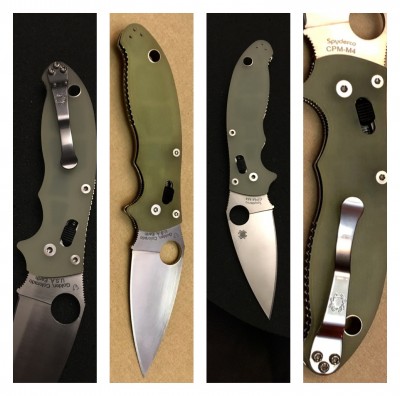

I bought this BHQ Manix 2 for a great price. The G10 looked dirty, but free of damage so I figured it was worth a shot. Turns out I was right! I got it looking as clean as any other jade G10 I’ve seen. I used a tooth brush to scrub lightly, and some simple green mixed in warm water. I didn’t want to take it apart, but the inside was full of gunk, so I had to clean it inside and out, anyway.
