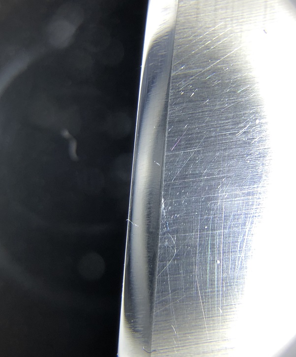

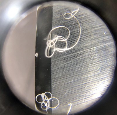

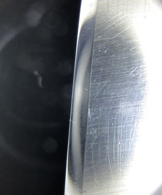

dgporter17
Posts: 2
Joined: Mon Dec 31, 2018 9:39 am
Re: Lupe: Asking for advice / recommendations please
Post by dgporter17 »
My first loupe arrived yesterday from Amazon--it was $9. It's the Dreame 30x/60x with a LED light. Made in China and feels/looks cheap but could not be more impressed with it so far. Here are two pics I was able to get by just putting my iPhone camera up to the loupe: first is the 30x and second is the 60x with whittled hair.

dgporter17
Posts: 2
cycleguy wrote:
Wed Jan 16, 2019 8:34 am
Thanks for the pic ... would like to see more of this from people who have them and use them ... really helps to make it tangible.
My internet findings on the jeweler's loupe - which is based on perspective of viewing gems and rocks (which I will use it for also) - keeps coming back to the Belomo 21mm and the B&L. This read reconfirms and has a comment comparing the two. http://earthtoadornment.com/best-jewelers-loupe/
User reviews I came across that were familiar with both were split between the two but each had mostly positive reviews from buyers.
They run low to mid $30 on amazon at the moment.
Sounds like it can be hit or miss with the less expensive offerings.
CG
Sorry--looks like the second pic didn't come through. This is the 60x loupe (12mm); I think the 30x is 22mm.
