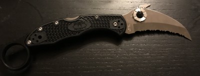

I did this. It doesn’t work that well.
I used a Tasman salt and wharncliffe delica 4.
The wharncliffe blade does not fit into the salt handles.
The Tasman fits into the delica handles, but here’s the thing with the Wiseman ring: the tip hits the aluminum ring back spacer, dulling the tip, so you have to close it carefully.
A folding karambit is also not worth doing unless you also install a fang opener.
All this would be less of a hassle if spyderco just made an h1 dragonfly hawkbill karambit and just saved everyone the trouble.

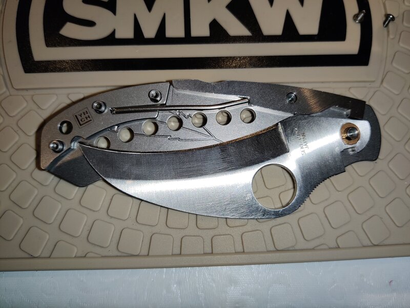

I did a swap with my Tasman 2 hawkbill and delica and LNW ti scales. I posted a while ago. Had to Dremel the back spacer to fit the hawkbill tip and sand down the lock bar thickness a bit if I remember correctly. Now if it's the first Tasman, I don't know.
