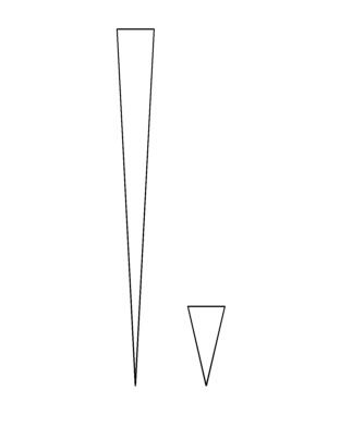

How do you make the primary FFG any thinner given a set thickness and height? I must not understand geometry too well.
I'm not an edge nut exactly. However, the basic geometry could go something like this. Say you start out with 2.5mm by I dunno, 25mm blade stock. A full flat grind simply means the primary grind goes the whole way down the blade stock at a consistent angle. If you made two knives, you could grind one where it is 2.5mm on the spine side, and is only 0.5mm on the edge side. You could grind the other where it is 2.5mm on the spine side and is 1.5mm on the edge side. Then you take both and put a 17 degree per side secondary bevel (the actual edge) on both. Both knives are the same size, both FFG from 2.5mm stock, both have a 17-degree edge on them. But one will be much thicker behind the edge. And the secondary bevel on one will look much wider than the other, in spite of being at the same angle.
I'd also point out that you could have say 2.5mm by 50mm stock (i.e. the blade will be wider from edge to spine). Perhaps you grind that at the same angle as the previous example that ends up being 1.5mm. Now it will only be 0.5mm at the edge, exactly the same thickness at the edge as the previous more acute knife. Except they have very different blade design. (I am not qualified to say which will cut better, etc).

It would appear that the angle of the flat grind and subsequent thickness at the edge depends directly on the height of the piece ground given the widths are the same.
Precisely.
But, given the same blade thicknesses between the two, both will get even thinner if the blade stock is made thinner.

Evil D wrote:
Mon May 28, 2018 6:26 pm
MichaelScott wrote:
Mon May 28, 2018 6:15 pm
Precisely.
Well... there’s more to thickness behind the edge than that diagram shows. Prior to adding the secondary bevels there is a flat at the bottom rather than a point. How wide that point is affects the thickness behind the edge once you add secondary bevels to get the edge.
This is why identical stock and blade height can yield different thickness behind the edge measurements.
Only if it were a zero grind. Two pieces of identical height and width could be ground to different thicknesses behind the edge in an FFG.
Well yes of course the edge bevel contributes to how thick the blade is. I made that diagram for another argument about taller blades vs shorter blades.

Couldn't sleep this morning, drew a diagram.
The diagram is obviously just to show what thicker and thinner mean. There are three measurements at play here: the stock thickness, the thickness behind the edge, and the secondary bevel angle/height. The primary angle is equivalent to the thickness behind the edge but in practice we just measure the thickness.
To the naked eye the thick/obtuse and thin/acute can look identical. It isn't until you actually measure the secondary angle that it becomes apparent why your knife performs the way it does.
If you've got a reasonably acute angle (25 - 35 included angle/12.5 - 17.5 dps) then the secondary bevel height is a good clue what's going on with the blade thickness. Tall secondaries look beautiful and we love seeing those polished and photographed, but they're basically just wasted thickness for most users. You need some visible bevel though or sharpening gets tricky.
