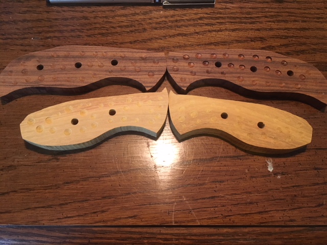

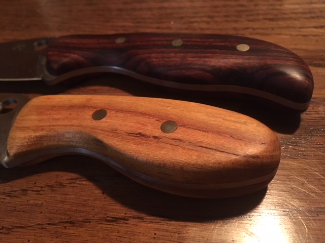

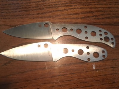

Just finished my first mule team project with the Micromelt A11. The smaller one is for myself and larger one for my dad's birthday. They are made from osage orange and desert ironwood. After rough shaping on a belt grinder, i finished them with progressively finer sandpaper and 0000 steel wool with multiple coats of food grade mineral oil and final layers of gunstock wax. Happy with my first attempt.
