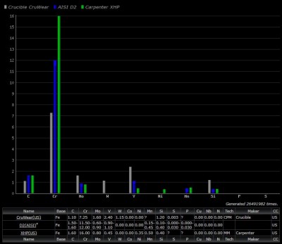

I have heard XHP and Cruwear both described as a variation of D2. I was just wondering how close they are to each other in comparison and what folks thought of each? I own both and love both but I can't tell a lot of difference between the two. But I am not really a heavy enough user nor enough of a steel junkie to get it.

CTS XHP and CPM Cruwear are really not very similar in composition, but they are both improvements over D2, albeit with different goals.
XHP will be a true stainless steel (16% chromium), and CPM Cruwear is far from stainless in that it has even less chromium than D2 (7.5% vs 12% respectively). Both CPM Cruwear and D2 have enough chromium to be considered semi-stainless, but neither will tolerate corrosive environments well.
CPM Cruwear has a healthy dose of tungsten and far more vanadium than D2 or CTS XHP for noticeably better abrasion resistance. CPM Cruwear also is formulated for improved toughness.
Thus, CTS XHP is a stainless with otherwise D2-like characteristics, while CPM Cruwear is a tougher, more abrasion resistant alternative to D2 at the cost of corrosion resistance.
Of course, ALL characteristics of an alloy are subject to changes in heat treatment schedules and alloying variables, making statements such as my above discussion only really good for qualitative comparisons.
ETA: was typing when above posts written. Sorry for some redundant info.

Pretty good stuff in this thread. I couldn't find anything to argue with here especially with Attila's description. XHP was a powder steel offshoot of 440XH ( stainless D2) just like Cruwear is a powder steel descendant of the original Vasco Pacific's Vascowear. That probably goes back even further but that is as far as I've traced it. Actual new alloys are fairly rare. 440XH was rare enough that I've never encountered it in my knife collecting. They (XHP & Cruwear) both sure make good knives IMO.

I'm going to beat a dead horse for a minute, but again I think it's interesting that iirc B70P was described by Ankerson as an upgrade to XHP and by Spyderco as basically a stainless Cruwear... but questions went unanswered, nobody had heard of it before, and it's basically been ignored.
I'm still curious to know more about it, and why Spyderco compared it to Cruwear (other than the carbon content it isn't obvious). My experience with the mules has been great, but I'm just a sample size of one and there's still very little out there about it.
:spyder:
Re: XHP or Cruwear?
Thanks for the chart, Nate. So B70P has about twice the chromium of CruWear but less than half the carbide forming vanadium and no tungsten. On paper I think I like CruWear the best, but I've used my CTS-XHP very little and didn't get the B70P mule.
