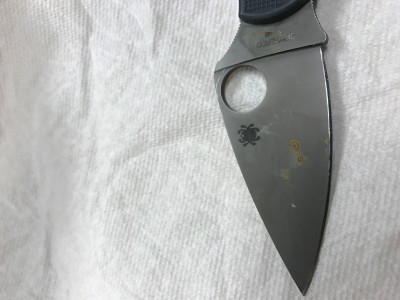

To start, the K390 Urban is first non stainless steel. I had some forced patina issues with it already, but it has not been used for several days. I grabbed it today and saw this. A good amount of rust. I live in Phoenix, dry and hot. But, I do keep my knives in a trey on my bathroom counter. Could showering and building up some humidity cause this level of rust? Or, would this only happen if I accidentally splashed some water on it?
I like the steel a ton, but running into these rust issues after less than 1 month with the knife. Again, living in Phoenix.

I'm guessing you run your A/C? I know my bathroom and the contents in it are colder than the showers we typically take. Condensation will definitely rust a non stainless blade.

Rust is better prevented than cured. I've been carrying the new Police 4 production proto, also made from K390. I like the steel because of the performance properties, but I also know that I must pay attention to maintenance and K390 requires more attention than most stainless steels.

I am new to these types of steels, so I will do a better job of keeping oil on it after use. I may need to send it to you guys to unthread the pivot screw as it just spins when turned, so unable to take it apart and clean out any rust in the pivot. Unless that does not matter...

It happens, if it was mine I'd shoot the pivot with some WD then Flitz the blade and call it good. :spyder:

I'd say the bathroom and showers had something to do with it definitely unless you accidentally got it wet. I'd move your case to the bedroom, the A/C in your house acts as a natural dehumidifier so it shouldn't be to "humid" in the house. I'd move your tray to your bedroom and try some flitz and wd40 as Dan mentioned! Nice knife choice by the way!

My advice is when you're not using it keep it coated on a thin layer of Vaseline and if you store it somewhere leave it in the box it came in and put a silicone packet in it.

I appreciate the advice, I will take it. I am moving my EDC knives from bathroom to bedroom and I will clean that sucker off and keep it oiled. I was spoiled with stainless before, it made me lazy

Sandpaper buddy. Most people get used to stainless steels and forget to treat knives as tools. No big deal, you may find you like sanding the blade a bit. Nothing quite makes a blade your own like doing something that keeps you from selling it later on. Once you make the move, though, you feel much freer to treat it as you want.

definitely don't keep non-stainless in the same room as a shower.

If you take a hot shower and there's condensation on the mirror, it's a sure thing water droplets condensed on the blade and caused the rust. Don't leave it in your shower. Remember it's not stainless. It looks like very minor surface corrosion so get a tube of Flitz and use a tiny amount about the size of a grain of rice and a rag and you'll buff it all off in a few seconds. For future use I always recommend USP mineral oil found in the laxative section of grocery stores/pharmacies. It's about $2 for a big bottle. Put a dab on a rag and wipe the blade down once a week if it's used or maybe once a month or so if it's not being used.

My K390 Pingo went through the washing machine and dryer and pretty much only got rust on the inside of the Spyder hole.

This is good advice. Vaseline not only has mineral oil in it, it also has paraffin wax. It is food safe and will adhere to the blade very well (even if you can't see it). Put a bit on, making certain to get the edge, and then wipe it off real good. You will have no more rust issues. I live in a place of 100% humidity, a bit of salt air, and high temperatures. I have had zero issues on any of my carbon blades, including K390, using Vaseline.Evil D wrote:My advice is when you're not using it keep it coated on a thin layer of Vaseline and if you store it somewhere leave it in the box it came in and put a silicone packet in it.

Remove the rust ASAP. Bar Keepers Friend. Wenol. Then coat the entire blade and pivot in oil and send it back to Spyderco to have them remove the pivot screw. I hope threads such as this propogate another round of CQI for pivots which anchor non-stainless blades. Such pivots should me made user maintanable!
