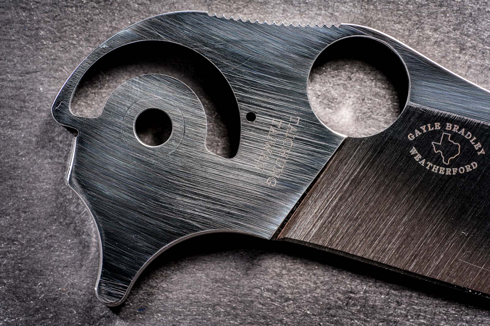

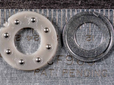

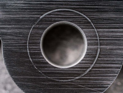

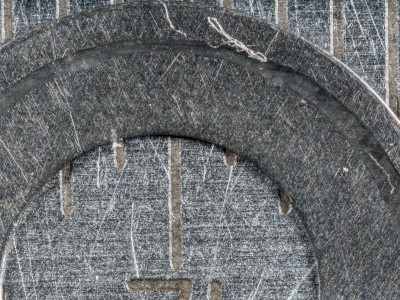

The Advocate checked all the right boxes for me so in spite of all the hubbub over the bearing problem I went ahead and ordered one. Forewarned, I figured I could prevent problems by doing a little hand fitting. So ten minutes after the red box arrived, I had the knife apart, lapping the blade tang with 15micron diamond film on a granite plate then 3 micron. I did not remove all the factory scratch pattern but got a near mirror polish that I figured would give those little balls an easier path to break in.
That was the theory; In practice I was too late; the knife came from the factory with dished washers and a bearing track already formed on the tang; but instead of a nice smooth wear pattern you would want to see, I found uneven wear, galling and the beginnings of a crack in one of the washers. Photos show the blade after polishing; bearings as they came from the factory.
So I have the knife back together, working nicely. I actually think I made the problem worst because it is impossible to reassemble the knife exactly as it came; there is a faint “rumble” in the action that I would equate to the sound wheel bearing in a car tell you they are going out.
I still like the knife, It is nicer looking in person than in photos, carries and handles beautifully and if Spyderco doesn’t come up with a retro fix, a pair of properly sized PB washers will take care of the problem.
- Attachments
Re: Gayle Bradley Advocate First Impressions?
Thanks for the photo evidence of the issue, parkeralto.
