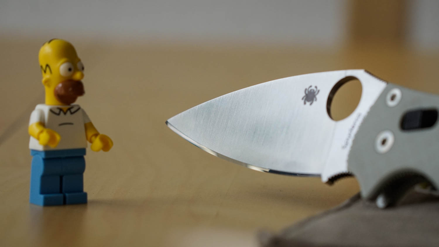

The knife was sharpened on my Edge Pro Apex (chinese clone, may buy original in future).
The EP is great for these small knives. As an experienced free-hand sharpener I am pleased with the evenness of the bevel. The sharpness is, and I'm being modest here, sublime. Here's the full progression:
Naniwa Chosera 400 (to get rid of the factory grind)
Naniwa Chosera 1k (to cut a nice even bevel)
Naniwa Chosera 3k (actually the polishing begins here, take your time with this stone)
Naniwa Chosera 5k (refine the polish and transition to the finish)
Naniwa Chosera 10k (establish a dark luster that mirrors)
The knife has not been stropped
The crispness of the bevel I believe is determined by a.) a properly ground bevel with on the lower grit and b.) enough refinement on what others have described fittingly as the transition stone. This is the stone where the balance between grinding and refining or polishing is shifted towards polishing. For the Chosera I believe this stone is the 3k or maybe the 5k. Spend some extra time on those stones to get that crisp bevel.
The mirror is not perfect. The Naniwa Chosera 10k will leave very shallow scratches that are visible under direct light.
However, the mirror is quite good, as you can see. I use a set of full size Chosera (or rather professional stones as they are called nowadays which is quite the scam: same price, thinner stones) for my kitchen knives. 80-90% of the time the mirror is good enough for me, which is saying something.
For my straight razors I have a full set of Shapton Glasstones including the elusive GS 10k and GS 30k. These are, perhaps, my absolute favourites, but reserved for razors (OCD level 9000). I have an almost full set of Shapton Professionals as well.
Since I have a Spyderco Cru-Wear Manix 2 with grey scales on my way I decided to purchase another set of stones for my Edge Pro.
Yeah, I like to have different sets of stones for differen knives... So I have a set of Shapton Professionals for the EP up to and including the EP Shapton Pro 30K. I will post images :)
Back again to the edge I produced with the Chosera. Mirror is 85% there which is close enough for anyone (almost).
The bevel is not complete. At the heel of the bevel close to the guard I have some difficulties establishing the bevel.

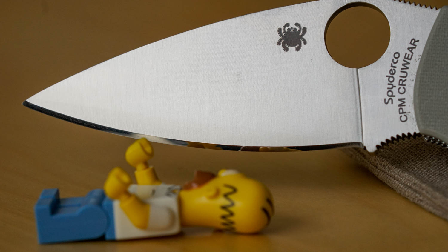

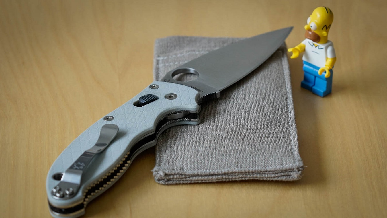

Finally, my Spyderco Manix 2 limited edition with Cru-Wear steel and light grey G10 scales.
This is such a beautiful knife. If you are thinking about getting one, do it. Now.
It is thinner than my Paramilitary 2 and cuts superbly. All fits together just great, the scales, the lock, the slide of the blade.
This knife has been sharpened using my Edge Pro and a whole set of Shapton Professional stones for the EP ranging from 2k to 30k
  • Shapton Professional 2k
  • Shapton Professional 5k
  • Shapton Professional 8k
  • Shapton Professional 30k
The polish on the bevel is superb, yet not perfect of course. The 30k leaves a liquid mercury polish but it is impossible to get rid of all the deep scratches from the grind. Nonetheless, the polish is extremely satisfying
