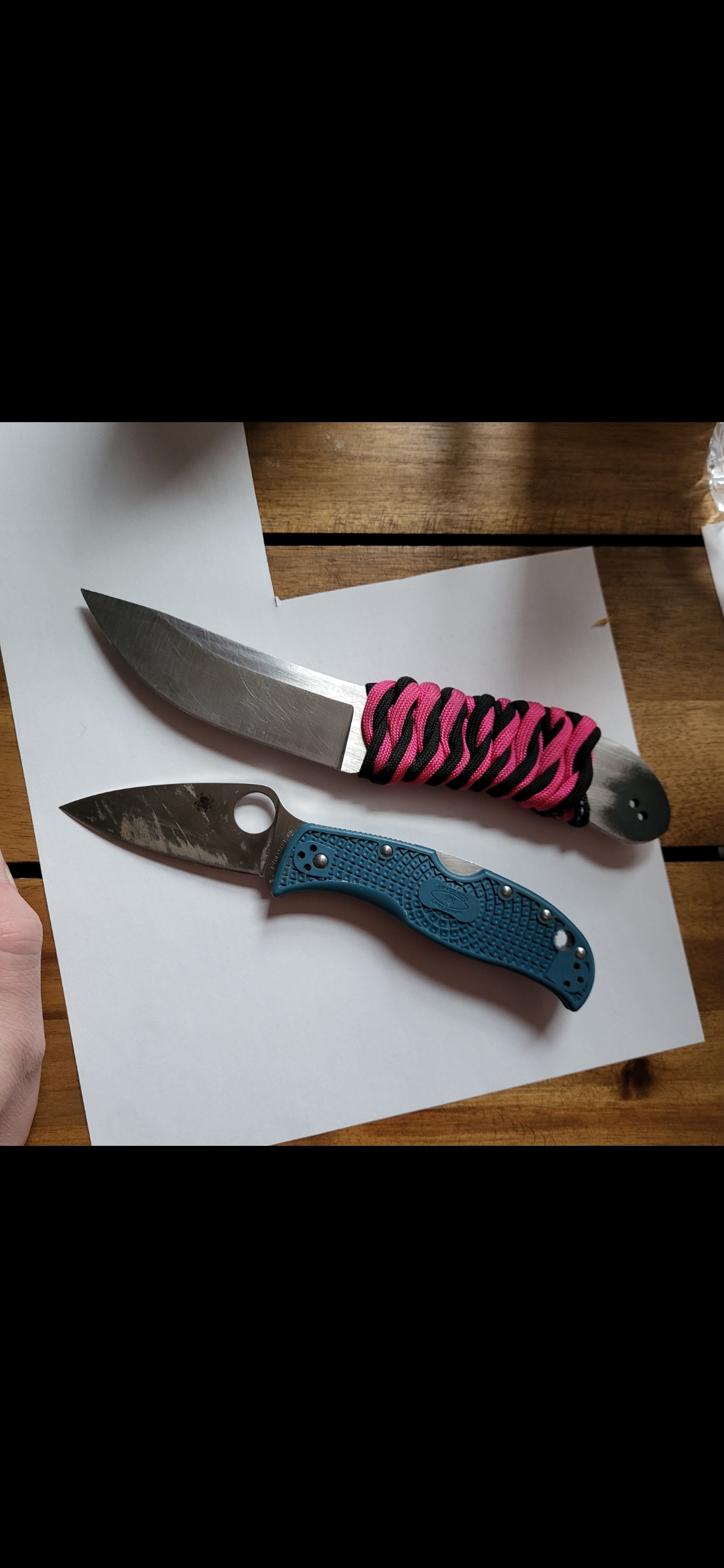

S60v at 65 hrc sharpened up yesterday for cut testing and performance evaluation.

I mentioned in a different thread about using s60v with triple B heat treat. In that same thread Shawn agreed to send Sal a test sample. I'm assuming the heat treat will be similar if not the same as this piece he graciously gifted to me years ago. Here's a comparison pic with my leafjumper. Sal seems interested in possibly making a mule team in s60v with what I assume is Shawn's help. That's if all the necessary boxes are able to be checked off. I'm not part of that decision process, but I can test the sample I own already. I do plenty of testing so I feel it's my civic duty to assist wherever I can to make s60v a mule team. Obviously it's a custom heat treat thats been dialed in thru trial and error to hit 65. I can say it apexed rather effortlessly and cut for a long time in my tests.
